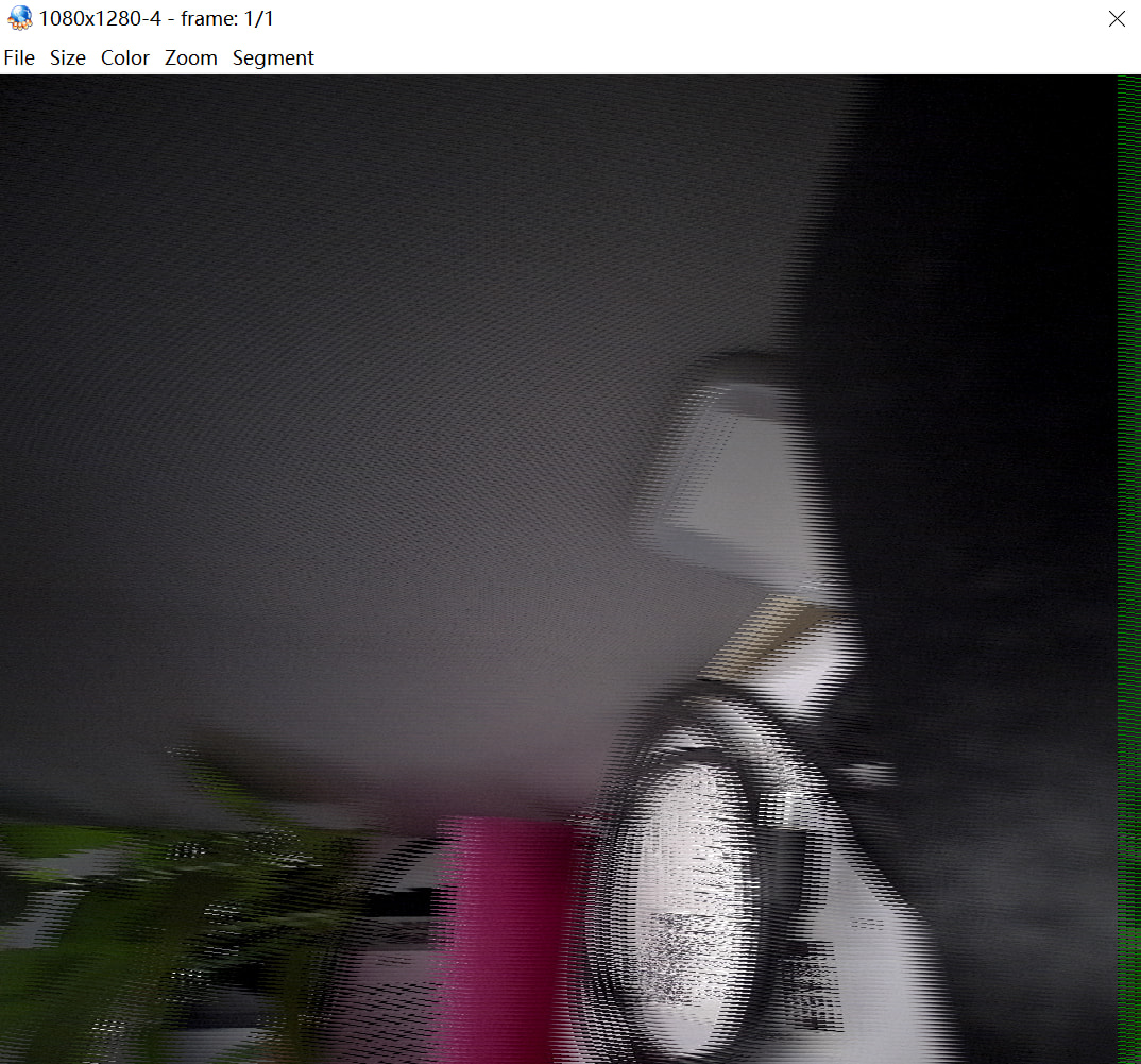

does jetson thor(jp7.1 T5000) support gmsl camera 1080x1280 (UYVY) ?
when I set 1080x1280, picture is blur, I set 1920x1280 picture is clear, camera register setting is same.

Set the preferred_stride to 64 alignment like below command.
v4l2-ctl -c preferred_stride=1088

capture cmd
v4l2-ctl --stream-mmap --stream-count=1 -d /dev/video6 -c preferred_stride=1088 --stream-to 1080x1280-1.raw
Try the 256 alignment by preferred_stride=1280

Please try 128 alignment like preferred_stride=1280
v4l2-ctl -c preferred_stride=1280
v4l2-ctl -C
v4l2-ctl --stream-mmap --stream-count=1 -d /dev/video6 --stream-to 1080x1280-2.raw

~$ v4l2-ctl --stream-mmap --stream-count=1 -d /dev/video6 --stream-to 1080x1280-4.raw
issue is not solved
hi nvidia:
if I set cam size to 1088x1280,
picture is good
Suppose it could be the tools(viewer) problem.
Could you try 7yuv to config the alignment to verify.

Adjust the align the stride should be changed. Like set align to 32/64/128 ..
32
64
128
hi nvidia:
I saw orin nx VI HW alignment is 32, what is thor VI HW alignment。
Byte alignment and the preferred_stride size - Jetson Systems / Jetson Orin NX - NVIDIA Developer Forums
Yes, suppose Thor should be the same with Orin/Xavier.
But don’t know why set the preferred_stride doesn’t help on it.
Maybe config the sensor output be 32 alignment for WAR.
