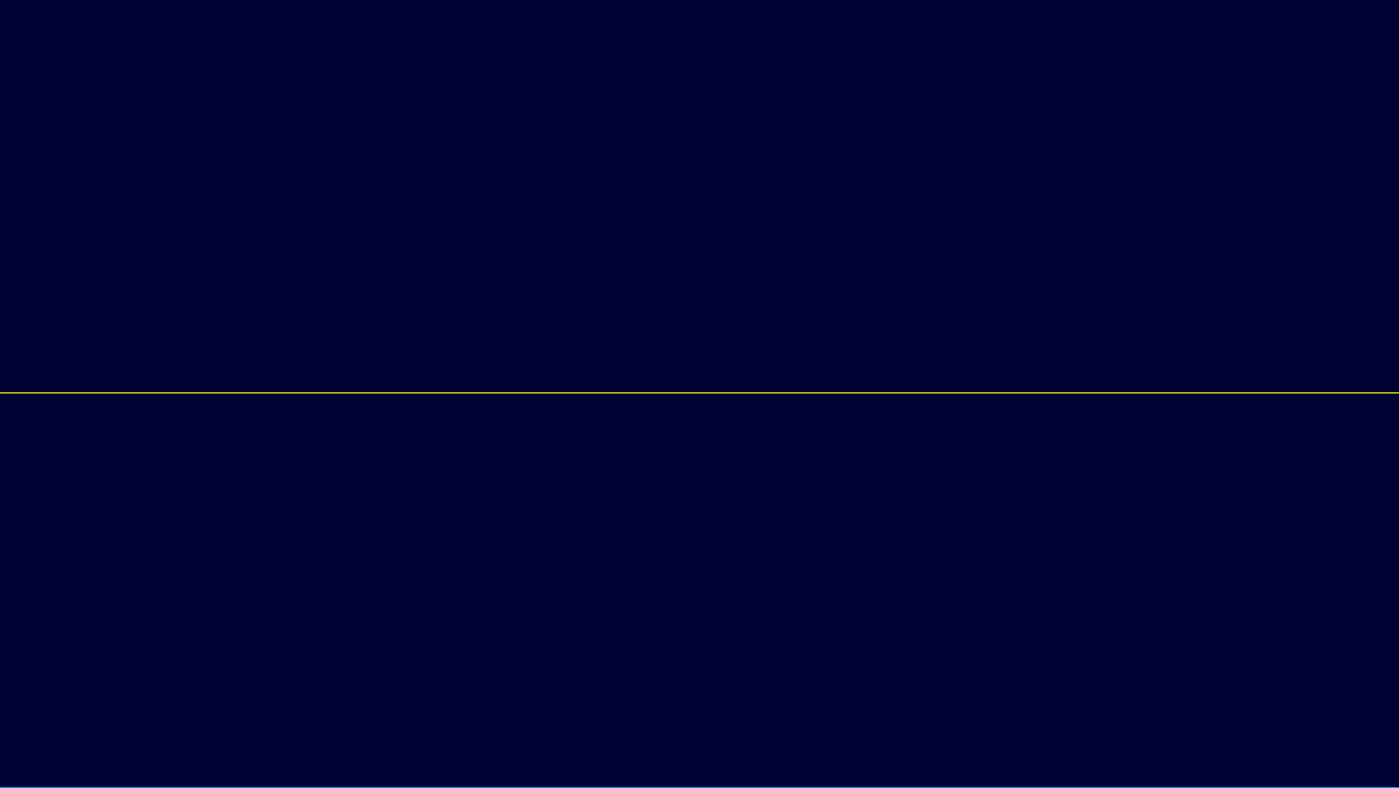

The issue is that the viewport is not properly clipping the vertices for a line.
I have managed to reproduce the issue on a minimal example with a fork of Sascha Willems’ triangle example.
It’s a simple example, where a line is drawn from x = -1000 to a x = 1000, with a viewport covering half of the screen width. The mvp matrix is the identity matrix so values are the same as NDC space.
Please see the repo below, the triangle project.
See the attachments.
