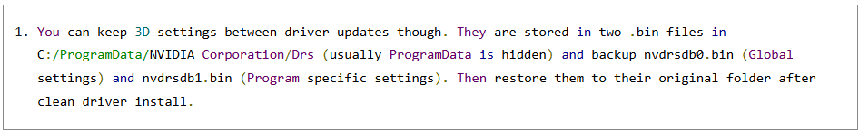

We like to package the NVIDIA Control Panel with our settings. So our users don’t have to change anything. We can’t find where the “Manage 3D settings” is stored for our graphic software “SCIA”. This company has a specific settings to let there software work properly
(Graphical issues and crashes (FAQ)).
We have tested with driver version “NVIDIA RTX Driver 570 R570 U3 (572.83)” and manual the specific “SCIA” settings in the NVIDIA Control panel, and there was no more crashes. Now we like to implemented this to all our “SCIA”-users devices, without to manual adjust the settings.
We have looked if the registry or a file changed when we adjust the “Manage 3D settings” settings, but we can’t find it. How can we accomplished this?
I found my solution on this site: Export / Import NVIDIA Control Panel | NVIDIA GeForce Forums
