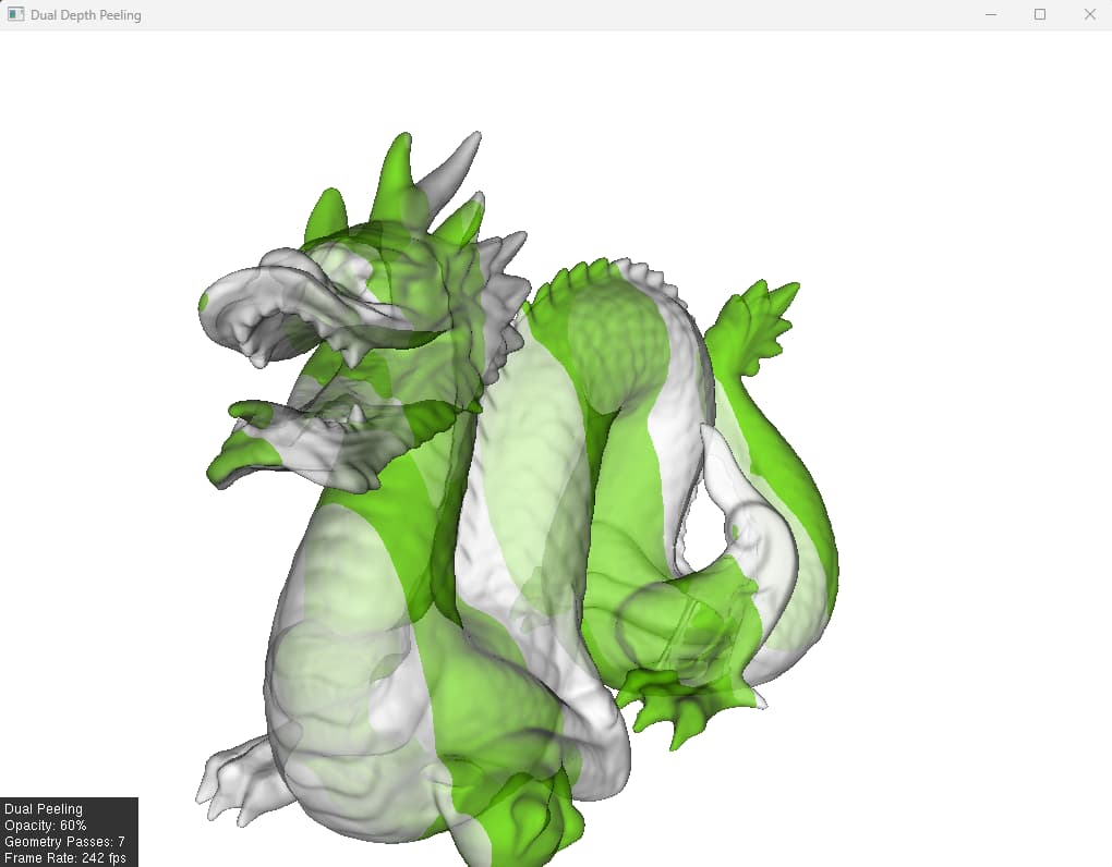

Hi there @sascha.heckmann, welcome to the NVIDIA developer forums.
I just updated my driver on an RTX 4080 and downloaded the package from your link. And it works without issues, see attached.
The paper is from 2008, so there could be any kind of incompatibility to current setups, but just given the original binary it seems to work?
