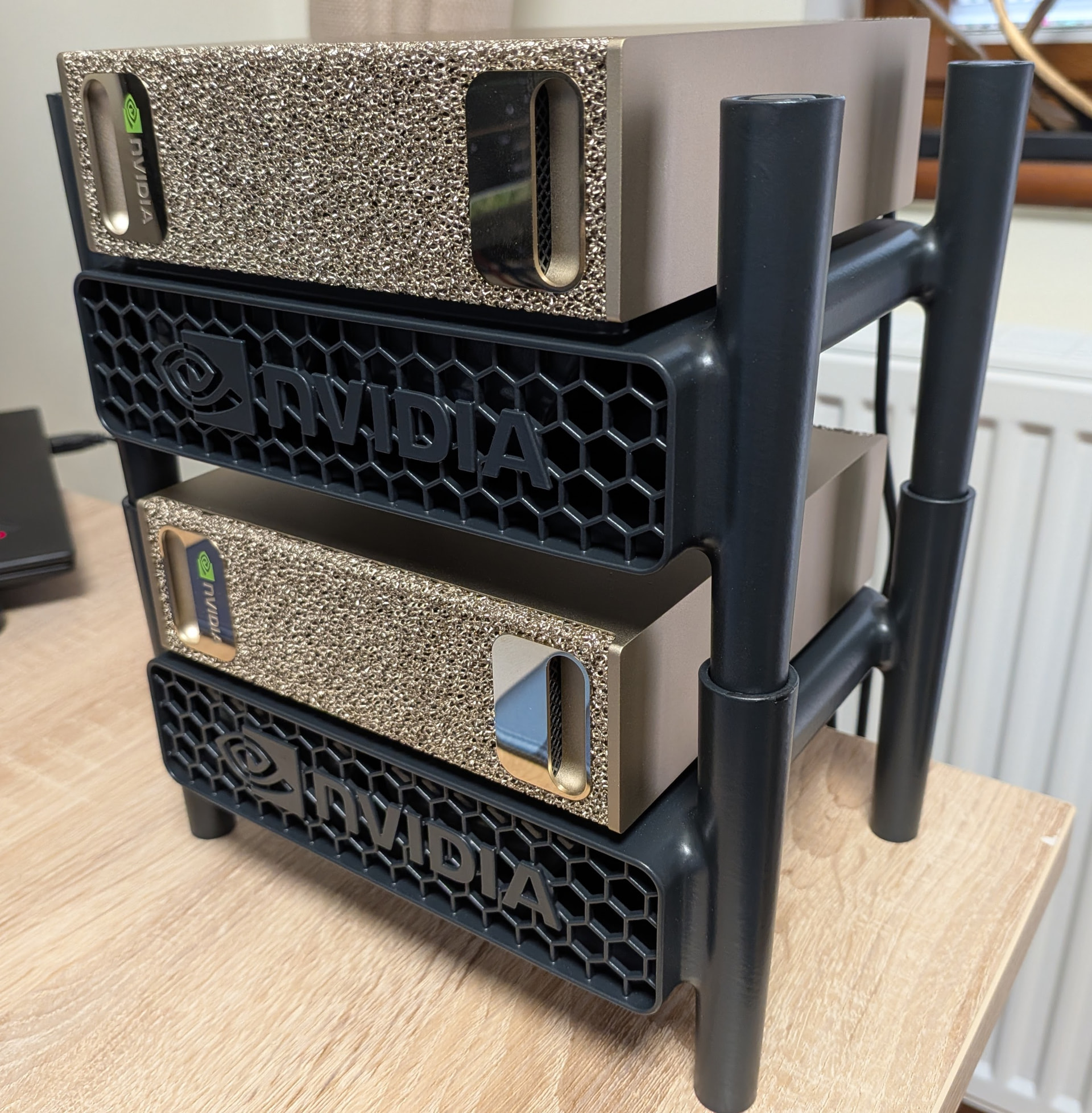

I’m getting dual Asus gx10 soon, what would be the best way to add cooling for them? I have a 3d printer and can get some extra noctua fans if needed. I’ve been reading this thread but there are some many designs, I’m not sure what would be the best for me.
I also have a 10" rack, so I can mount them there, or by themselves
I say run them for a while and see if you want them to run colder. Unless the units are defective they won’t overheat and crash under load.
I’m making my own cooling solution because I’m curious to see if I can keep them under 70C during sustained load. They can hit up towards 87C without additional cooling. They are however 100% stable.

This is mine, I’m still waiting for the blower fans but I have 2 more stands being printed right now. Hopefully the stands will arrive next week.
