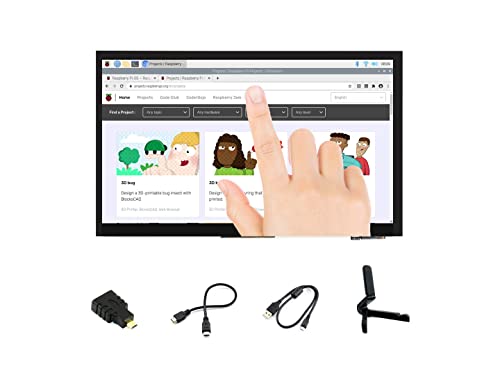

This panel works for me.
Amazon.com: ELECROW Raspberry Pi Touchscreen Monitor 5 inch HDMI Screen Display 800x480 Compatible with Raspberry Pi 4 3B+ 3B 2B BB Black Banana Pi Windows 10 8 7: Computers & Accessories
