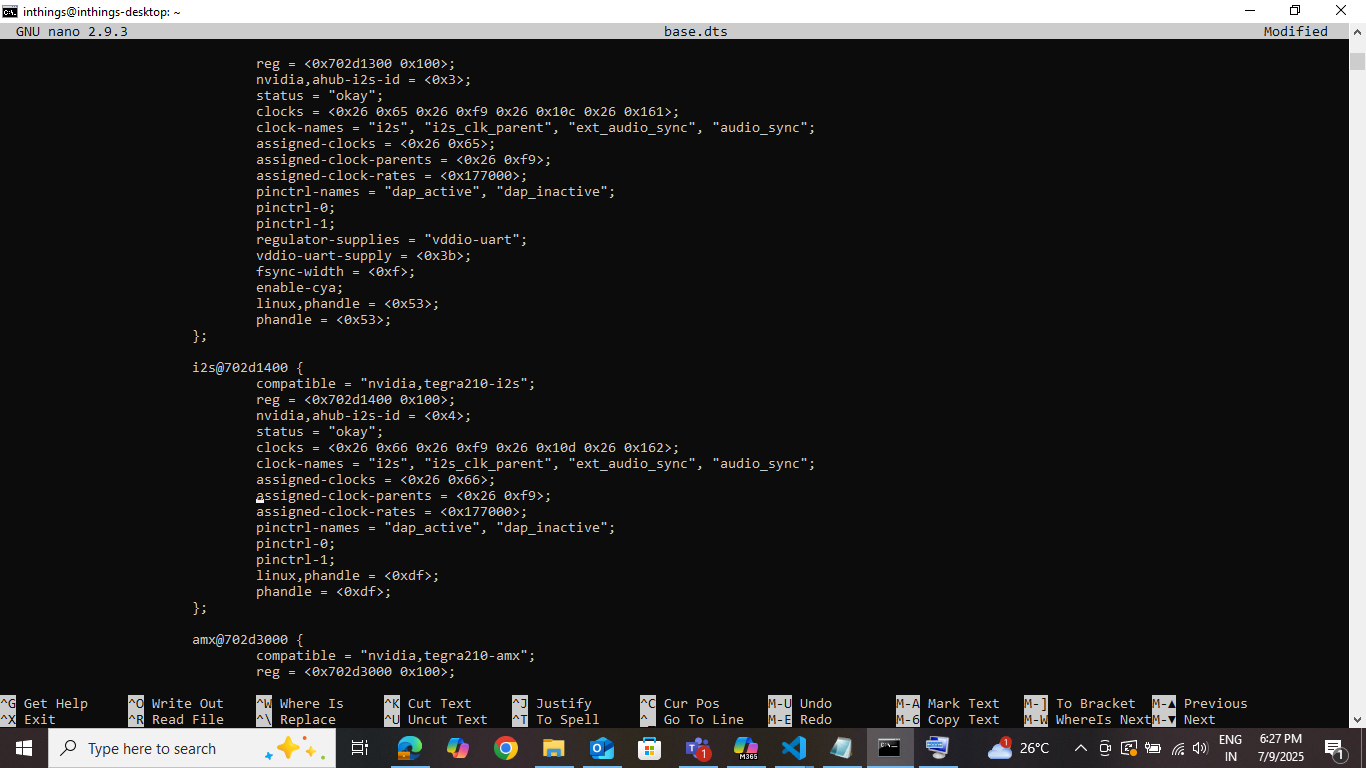

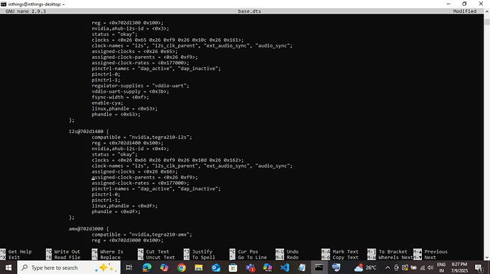

Hi atalambedu
  • Compiled the overlay and placed it in /boot/overlays/:
    dtc -I dts -O dtb -o /boot/overlays/tegra-i2s4b-overlay.dtbo tegra-i2s4b-overlay.dts
  • Decompiled /boot/kernel_tegra210-p3448-0000-p3449-0000-b00-user-custom.dtb, edited the node:
i2s@702d1400 {
status = “okay”;
  • Recompiled with:
sudo dtc -I dts -O dtb -o /boot/kernel_tegra210-p3448-0000-p3449-0000-b00-user-custom.dtb base.dts
  • Rebooted:
sudo reboot
  • Checked I2S status after reboot:
    for node in /proc/device-tree/ahub/i2s@*; do
    echo -n "$node: "; cat “$node/status”; echo;
    done
then still disabled why ? and Which I2S interface is supported on the 40-pin header of the Jetson Nano? Is it I2S4?
My bad, Orin Nano has I2S2 on 40-pin header.
Please check the board interfaces listed here : Audio Setup and Development — NVIDIA Jetson Linux Developer Guide
But this should have been visible when you used Jetson I/O tool. May be it went out of notice
Further i2s@702d1200 may be relevant node where you have check if its status is okay
If not, we may have to edit relevant dtsi files mentioned in the alternate method and enable i2s2
Hi atalambedu
i2s@702d1200 {
compatible = “nvidia,tegra210-i2s”;
reg = <0x702d1200 0x100>;
nvidia,ahub-i2s-id = <0x2>;
status = “okay”;
clocks = <0x26 0x12 0x26 0xf9 0x26 0x10b 0x26 0x160>;
clock-names = “i2s”, “i2s_clk_parent”, “ext_audio_sync”, “audio_sync”;
assigned-clocks = <0x26 0x12>;
assigned-clock-parents = <0x26 0xf9>;
assigned-clock-rates = <0x177000>;
prod-name = “i2s2_prod”;
pinctrl-names = “dap_active”, “dap_inactive”;
pinctrl-0;
pinctrl-1;
regulator-supplies = “vdd-1v8-dmic”;
vdd-1v8-dmic-supply = <0x3b>;
fsync-width = <0xf>;
linux,phandle = <0x55>;
phandle = <0x55>;
did this but still show disabled why ? what are the alternative method to enable 12s ?
~0730
Which dts did you edit? tegra234.dtsi?
How did you recompile and flash the new kernel dtb?
