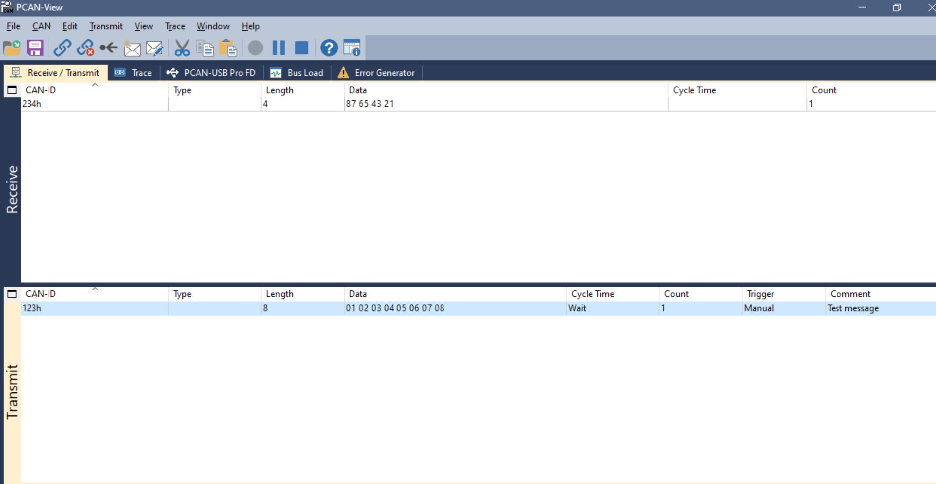

I also tested send/receive data from PCAN. For this test, the connection should be like below
I used below setting for PCAN view and tested sending CAN message
After selecting Transmit and send, I see below message on tegra terminal
root@tegra-ubuntu:/home/nvidia#   can0  RX - -  123   [8]  01 02 03 04 05 06 07 08
  can1  RX - -  123   [8]  01 02 03 04 05 06 07 08
  can1  123   [8]  01 02 03 04 05 06 07 08
Now I tested sending data from tegra like below and CAN message is noticed on PCAN receive window.
root@tegra-ubuntu:/home/nvidia# cansend can0 234#87654321
  can0  TX - -  234   [4]  87 65 43 21
  can1  RX - -  234   [4]  87 65 43 21
  can1  234   [4]  87 65 43 21
