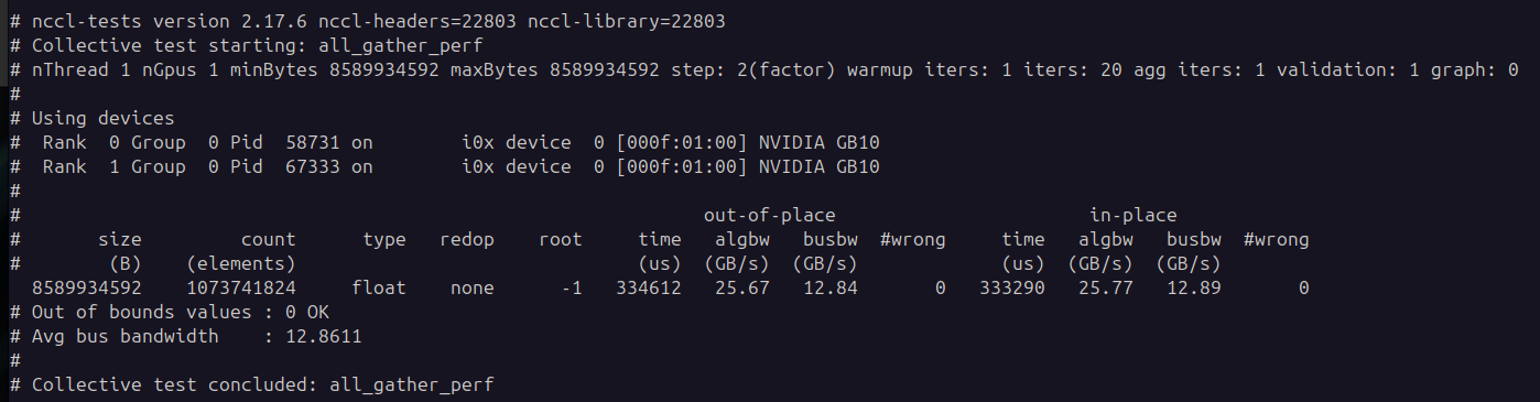

This is as close as I got:
 ![Screenshot from 2025-11-20 01-36-37](https://global.discourse-cdn.com/nvidia/original/4X/1/2/4/1247505ab7f5e90ec13a7b27169e742405a622dc.png)
 ![image](https://global.discourse-cdn.com/nvidia/original/4X/2/d/5/2d5812ba38f39462dd196a3c60b3366bd5b449db.png)

#### Performance Results
NCCL all\_gather\_perf test (8GB buffer):
- Achieved: **25.67 GB/s** (~208 Gbps)
- Theoretical max: 50 GB/s (400 Gbps)
- Efficiency: ~52%

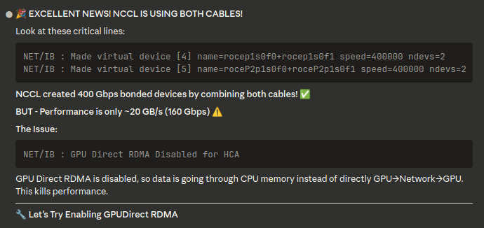

Before I dropped the note above that was one of the assumptions Claude code made, assuming the current path looks like this not factoring in the unified memory of each individual Spark:
`GPU Memory → PCIe → CPU Memory → PCIe → Network Card → Network`
` BOTTLENECK!`

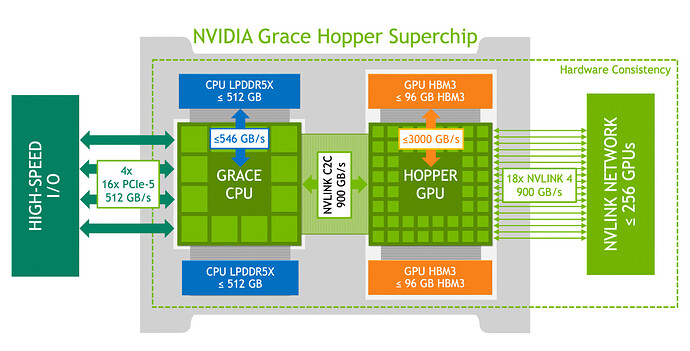

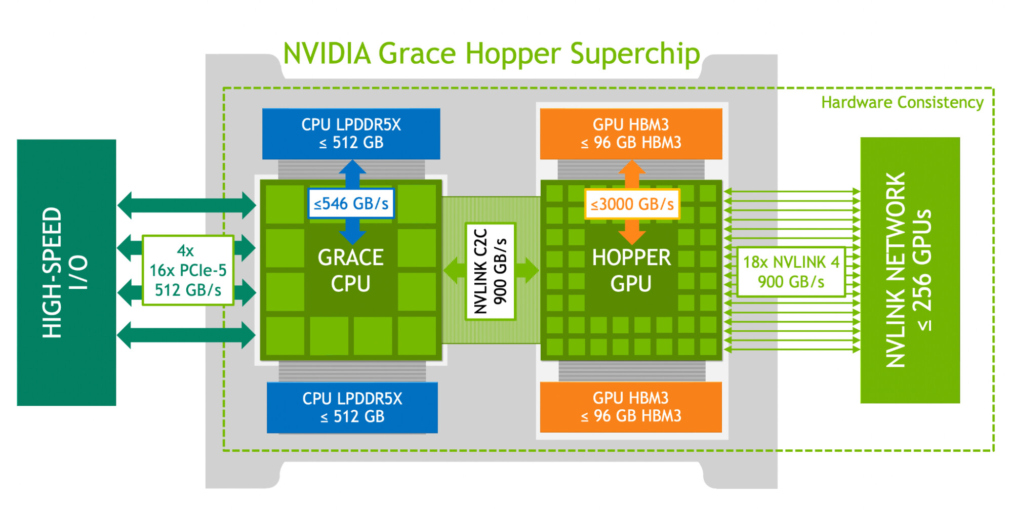

There are no other options for zero-copying from NIC to GPU memory and a firmware update won’t add it from what I can tell. This is due to the architecture of the system. Unlike it’s bigger brothers, the GB10 has no memory (normally HBM in the larger systems) attached to the GPU. So there is no memory to directly load data to from the NIC. There is just LPDDR5 memory attached to the CPU. So the GPU is always accessing data across the infiniband C2C (chip to chip) link that connects the CPU and GPU as far I can tell. This means that you can RDMA data to a host allocated buffer and then just pass that pointer to CUDA without a H2D copy from my personal testing, since the virtual addressing appears to be the same. But your mileage may vary. I do agree though that the marketing around this device could have been better as this is really just 3/4 of a larger DGX system and may not be a great representation of how one of the larger systems operate.

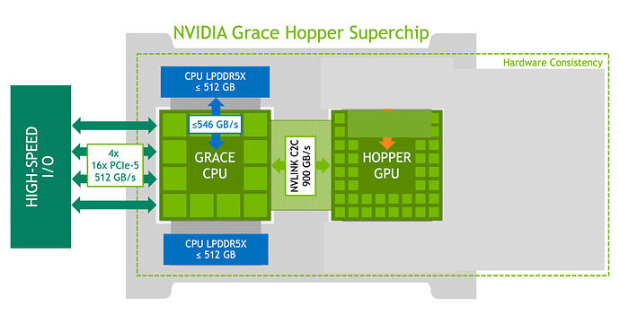

While a little dated here is a good diagram that represents what I think the architecture for the full fat grace blackwell systems looks like: [grace-hopper-overiew](https://developer-blogs.nvidia.com/wp-content/uploads/2022/11/grace-hopper-overview.png)
 ![grace-hopper-overview](https://global.discourse-cdn.com/nvidia/original/4X/4/3/5/435d2b998a80c6b0d472502f2e45dc98f6944533.jpeg)

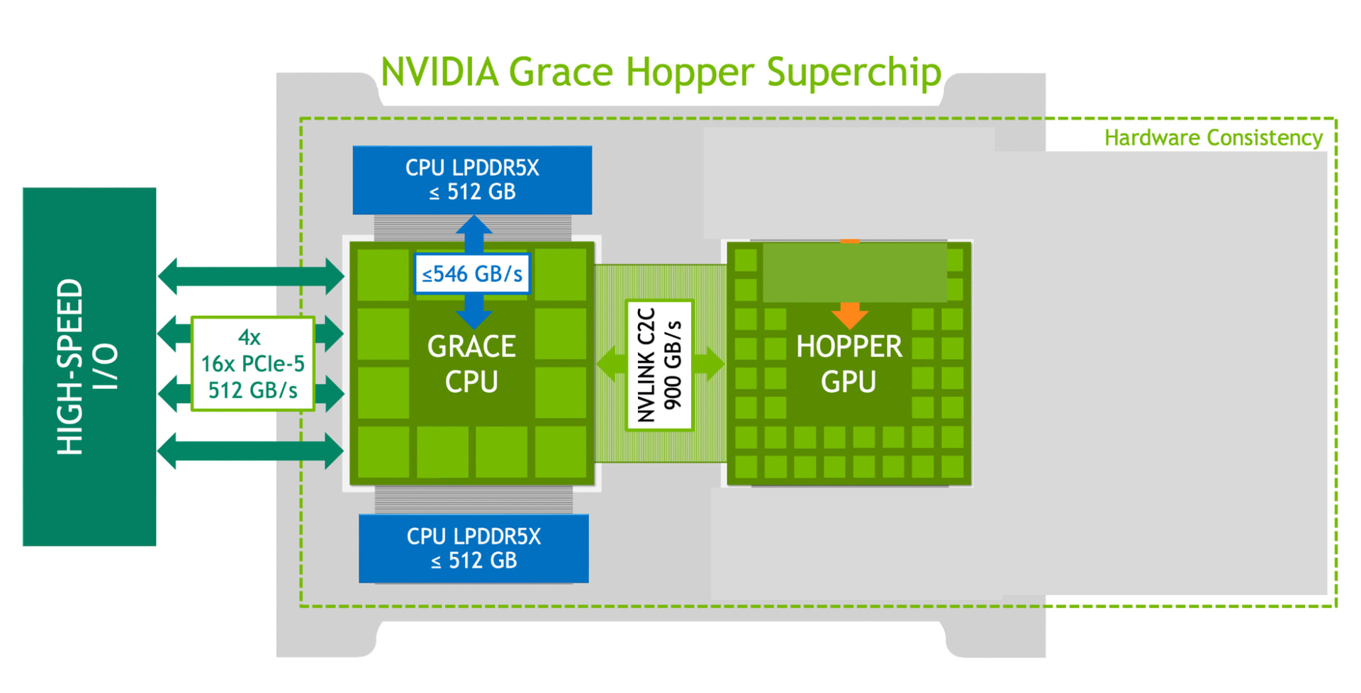

And here is a terrible photoshop of that picture that I think depicts roughly the architecture of the spark:
 ![rough_spark_acrhitecture](https://global.discourse-cdn.com/nvidia/original/4X/7/a/2/7a2602650bc7592ef4ec14860f434f07e8edb9f7.jpeg)
TLDR: No GPU memory, no GPUDirect RDMA.
