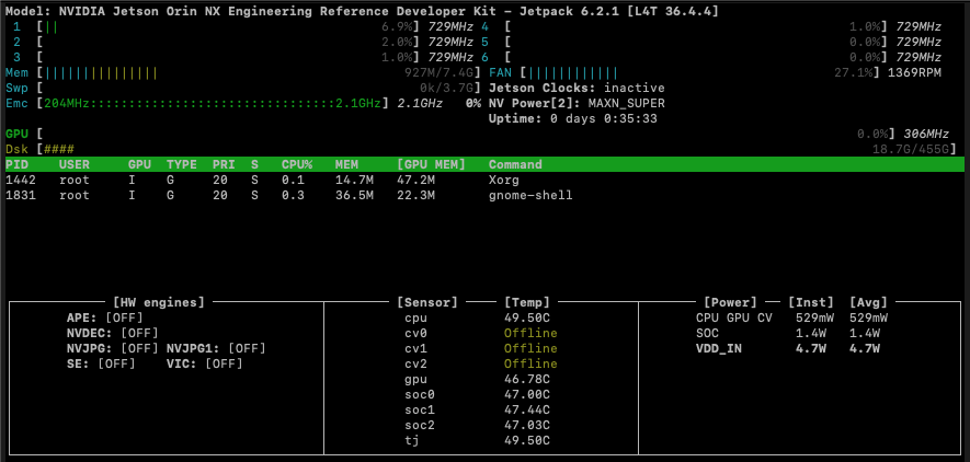

I want to enable Maxn on Jetson Orin Nano i use sdk manager to download JetPack 6.2.1 on ssd . I try sudo rm -rf /etc/nvpmodel.conf and reboot it. but nothing happen and i exexute jtop it show me JetPack not detected.
Any solution ?

Hi @haddadmootaz
Have you tried changing the power mode directly in the GUI after the reboot? As mentioned on this page
And regarding the jtop problem, it might just be that the tool is not updated for that L4T version: jetson-stats not supported for [L4T 36.4.4] · Issue #679 · rbonghi/jetson_stats · GitHub

Please do
  1. Re-flash the system to Jetpack 6.2.1 through SDKManager with super mode enabled
  2. Run the command: $ sudo nvpmodel -m 2
  3. Reboot the system
For Orin Nano modules, MAXN_SUPER mode is mode 2 instead of mode 0 per:
Jetson Orin Nano Series, Jetson Orin NX Series and Jetson AGX Orin Series — NVIDIA Jetson Linux Developer Guide
i updated jetson-stats from this jetson-stats not supported for [L4T 36.4.4] · Issue #679 · rbonghi/jetson_stats · GitHub to detect the JetPack and to enable MAXN_SUPER bu running this command“sudo cp /etc/nvpmodel/nvpmodel_p3767_0003_super.conf /etc/nvpmodel.con && sudo reboot”
