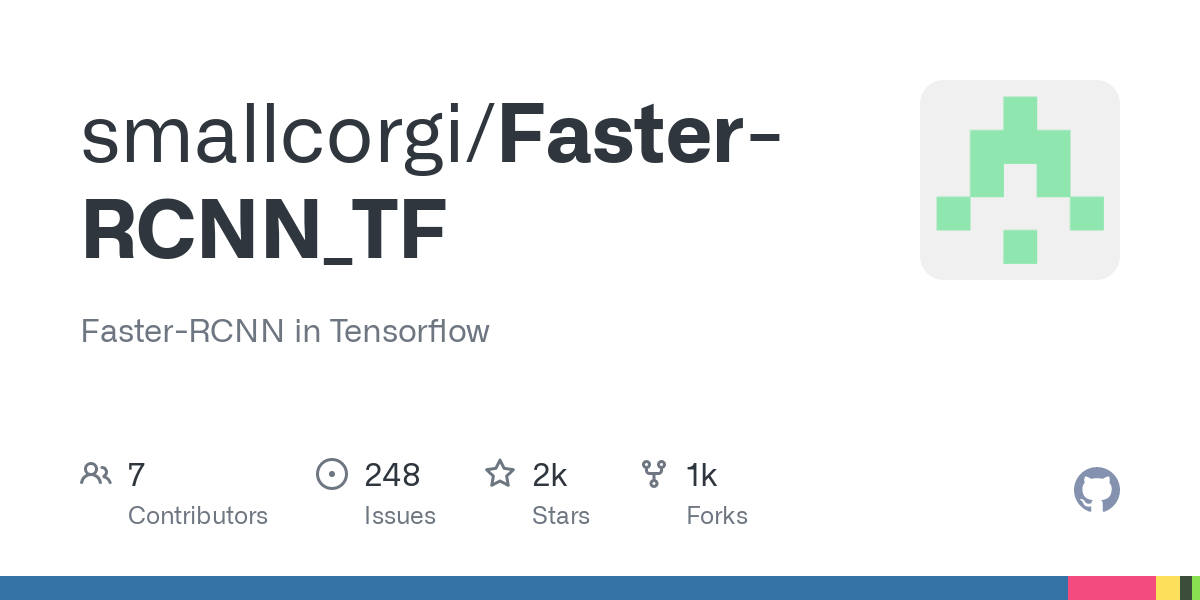

When I run the algorithm given in this link :
I am facing this error:
python demo.py --model /home/techm/Faster-RCNN_TF/VGGnet_fast_rcnn_iter_70000.ckpt
