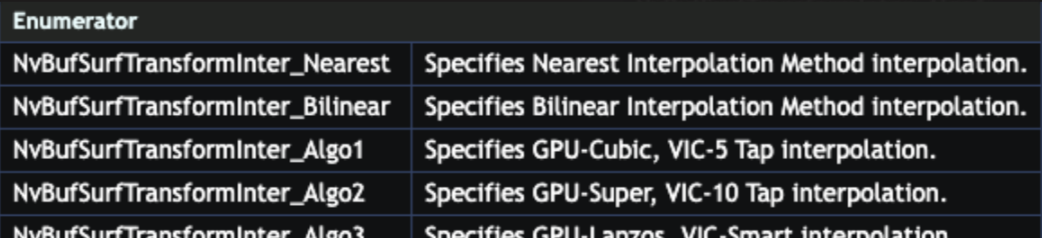

Here is the scaling-filter doc

There has to be a way to use “Bilinear” interpolation with dGPU, isn’t it?
dGPU only supports bilinear, so the following parameters should work.
scaling-compute-hw=1
scaling_filter=1
Ok. Got it, Also, as per this table, is the “Nearest” method the default one or only used when scaling-filter=0?
Yes, It’s true.
But I don’t get this error on using DS7. Also, using scaling-filter=2 gives me numbers closer to onnx counterpart.
