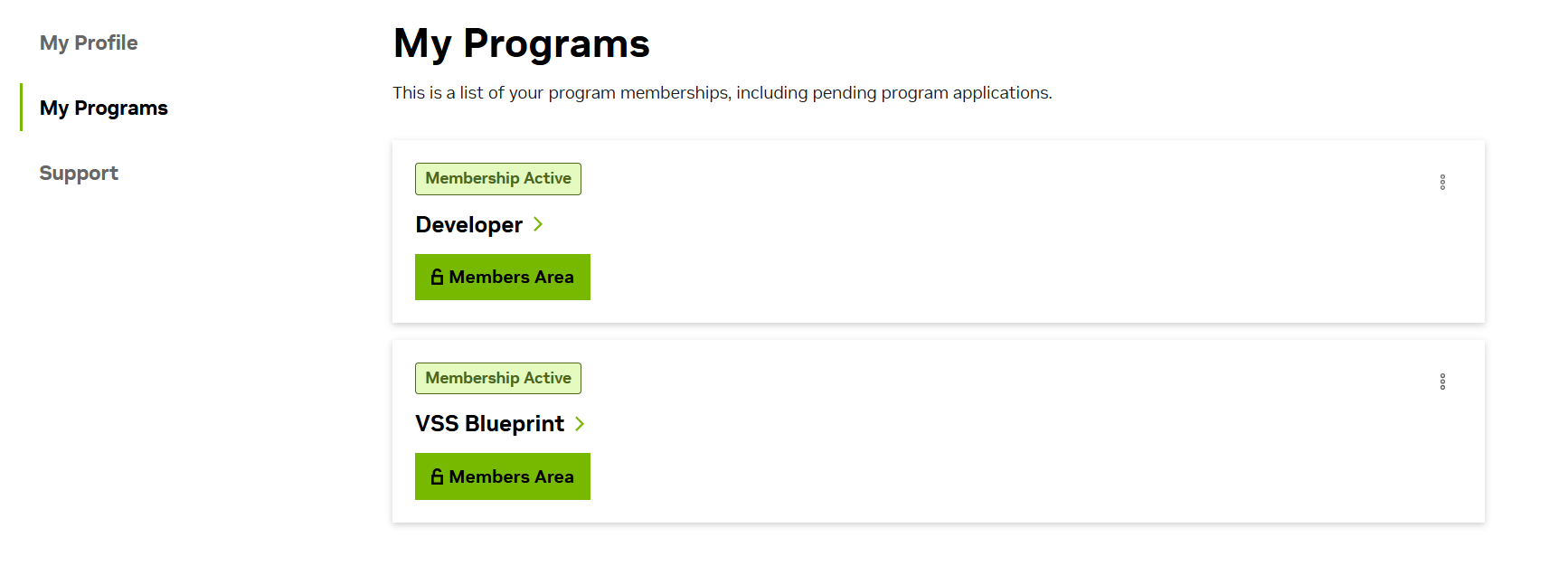

In the 1_Deploy_VSS_docker_Crusoe.ipynb it is mentioned that
Note: If you have authentication issues when pulling the NIMs, please verify you have the following Subscriptions: NVIDIA Developer Program and VSS Early Access

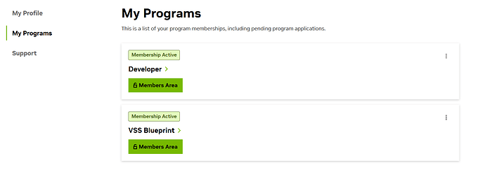

In my subscription, I only see NVIDIA Developer Program and no VSS Early Access. I have registered and accepted for Early Access Program for Video Search And Summarization NVIDIA AI Blueprint, however.
I fixed the issue by making sure both NVIDIA Developer Program and VSS Early Access subscriptions are mapped to my account. Ok to close the issue
