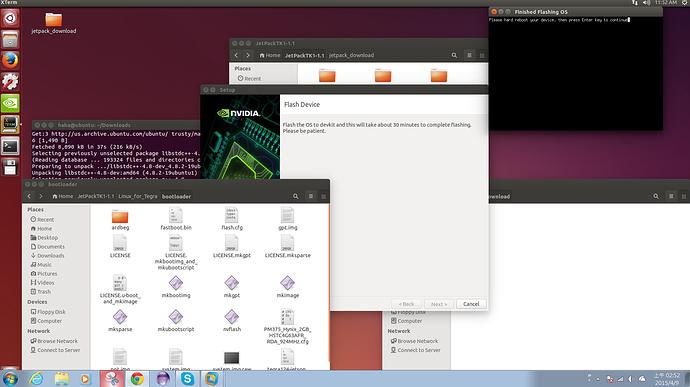

just like the other post, rerun the JetPadk will help, however, I've rerun in stupid ways such as : sudo su or sudo ./JetPack... both failed, then I restart my host > rerun JetPack > reuse parts of the downloaded files > (surf the internet) > suddenly came to Flash step !! (Happy :D) Failed.... seems to be either my smartphone plug or the storage is not enough (vm host linux) I am going to recreate a vm host and do it again..... :'( Successfully Flashed , now push and install Components for Target :D:D:D I think it's important that the host has enough space (30GB up before start JetPack) also needs to be update and upgrade with latest softwares(using software updator), then apt-get the g++, then run the JetPack without sudo (chmod +x JetPack... then ./JetPack...)
