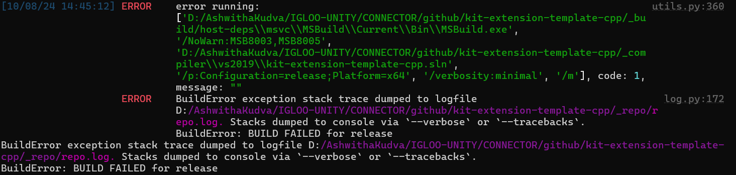

I am facing the following error on building the kit-extension-template-cpp in Windows. Please help me in solving this issue.
Can you try cloning and building the kit-extension-template-cpp in a different location? Could you also post the repo.log that it mentioned as well.
If you could try again but do not include any special characters in the file path like “-”. So for example rather than using “IGLOO-UNITY” just make it “IGLOOUNITY”.
