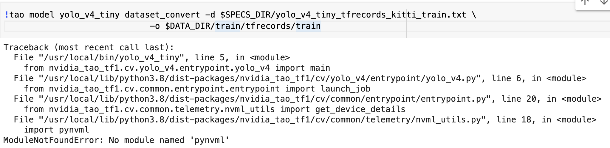

I am trying Running TAO Toolkit on Google Colab.
Here is the link
Object Detection using Yolo V4 Tiny
When I run the below cell
and here is the error
Please let me know how to resolve the above error occurred.
Could you please copy the full log of this cell and upload it via button
log.txt (794.1 KB)
Because the log output from this cell exceeds 5000 lines, it does not display the entire log. If the information in this log is insufficient, I can prepare a complete version separately.

I can get similar error log as yours. Internal team will check further.
after install pynvml gave this error:

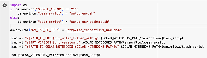

Sorry, there are some code I forgot to delete in that colab link
the below image is the code that can be deleted in that colab link
Has the current issue been resolved?
This is a regression issue found recently. Internal team is working on that. Will update to you if I have. Thanks.
Im having the same issue
Please rerun the colab. We fix it by doing some changes on two files. It is already merged. You can run the colab as previously.
The detailed info can be found in [BUGFIX] Fix issues caused by pip version and mpi4py version · NVIDIA-AI-IOT/nvidia-tao@5c9a6b0 · GitHub.

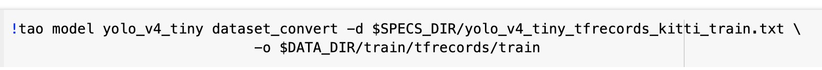

When I run the command below, it get this output

Seems it is a new issue. I think the original issue is gone, right?
Please create a new forum topic for tracking. Thanks a lot.
