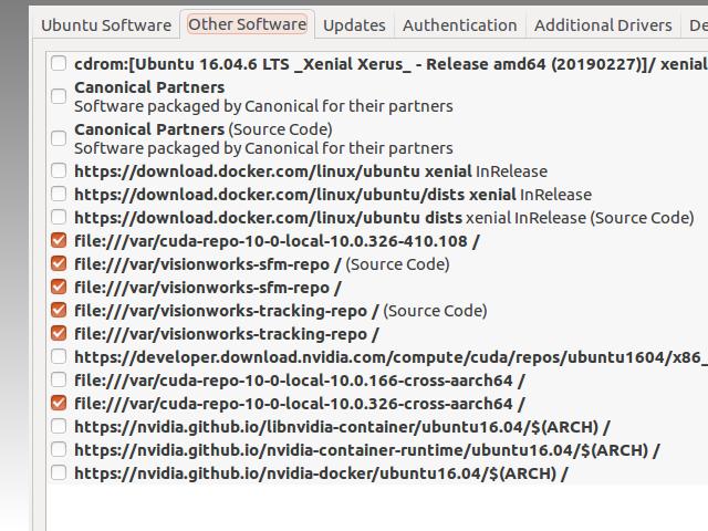

**Author:** ![Q150shinchen](https://developer.download.nvidia.com/images/forums/profile-default-devtalk-84.png) [@Q150shinchen](https://forums.developer.nvidia.com/u/Q150shinchen)\
**Post date:** [March 25, 2020, 1:14am UTC](https://forums.developer.nvidia.com/t/error-when-install-cuda-host-and-other-package-by-sdk-manager/116350/4 "2020-03-25T01:14:44Z")
</div>
Sorry being late.
Firstly, thanks sir, but these command seems doesn’t work. (nothing updated or fixed)
Finally i solved (or say skipped) this issue by setting up the “software & updates\>\>other software setting”.
- i unchecked some items not necessary(that seems cause the errors)
 ![456465](https://global.discourse-cdn.com/nvidia/original/2X/e/ec39ea56bbc9fc72944a4b9fe7785f953d6014ea.jpeg)
