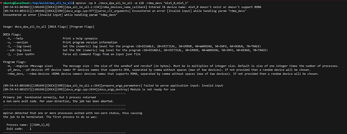

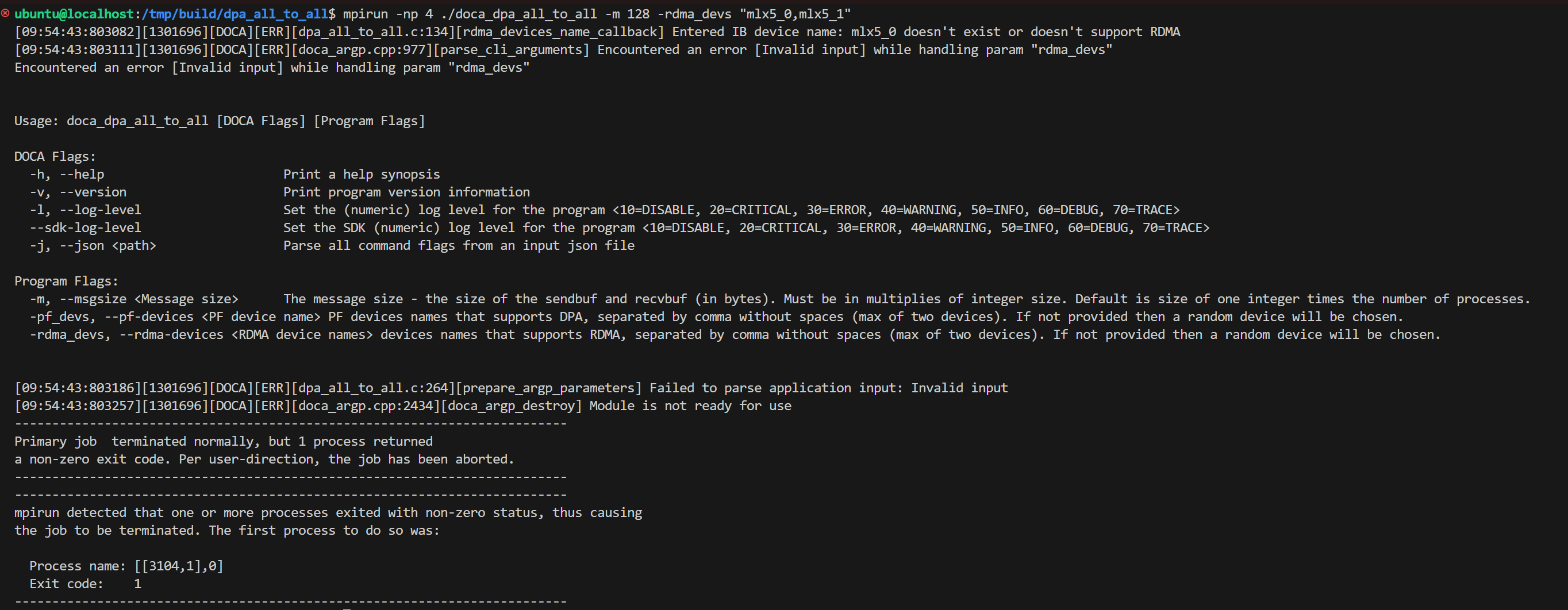

I am trying running the /opt/mellanox/doca/applications/dpa-all-to-all demo. However, When I tried to specify running dpa-all-to-all in RDMA devices mlx5_0 and mlx5_1, it dropped a new error saying tha t mlx5_0 doesn’t exist or doesn’t support RDMA:

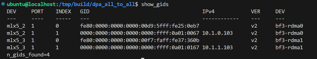

I guess that it is because there no RDMA functionality in mlx5_0 and mlx5_1. I explored the RDMA devices in BF3, using show_gids, it shows:
It is interesting that there are no mlx5_0 and mlx5_1.

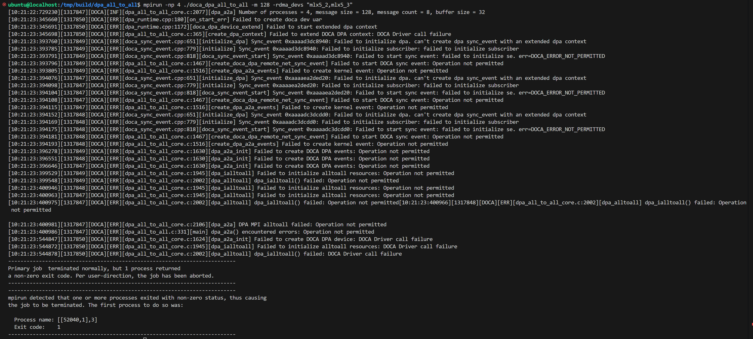

When I tried to specify the RDMA device to mlx5_2 and mlx5_3, I encountered another bug that saying “Failed to create doca dev uar”, as shown in the figure below:

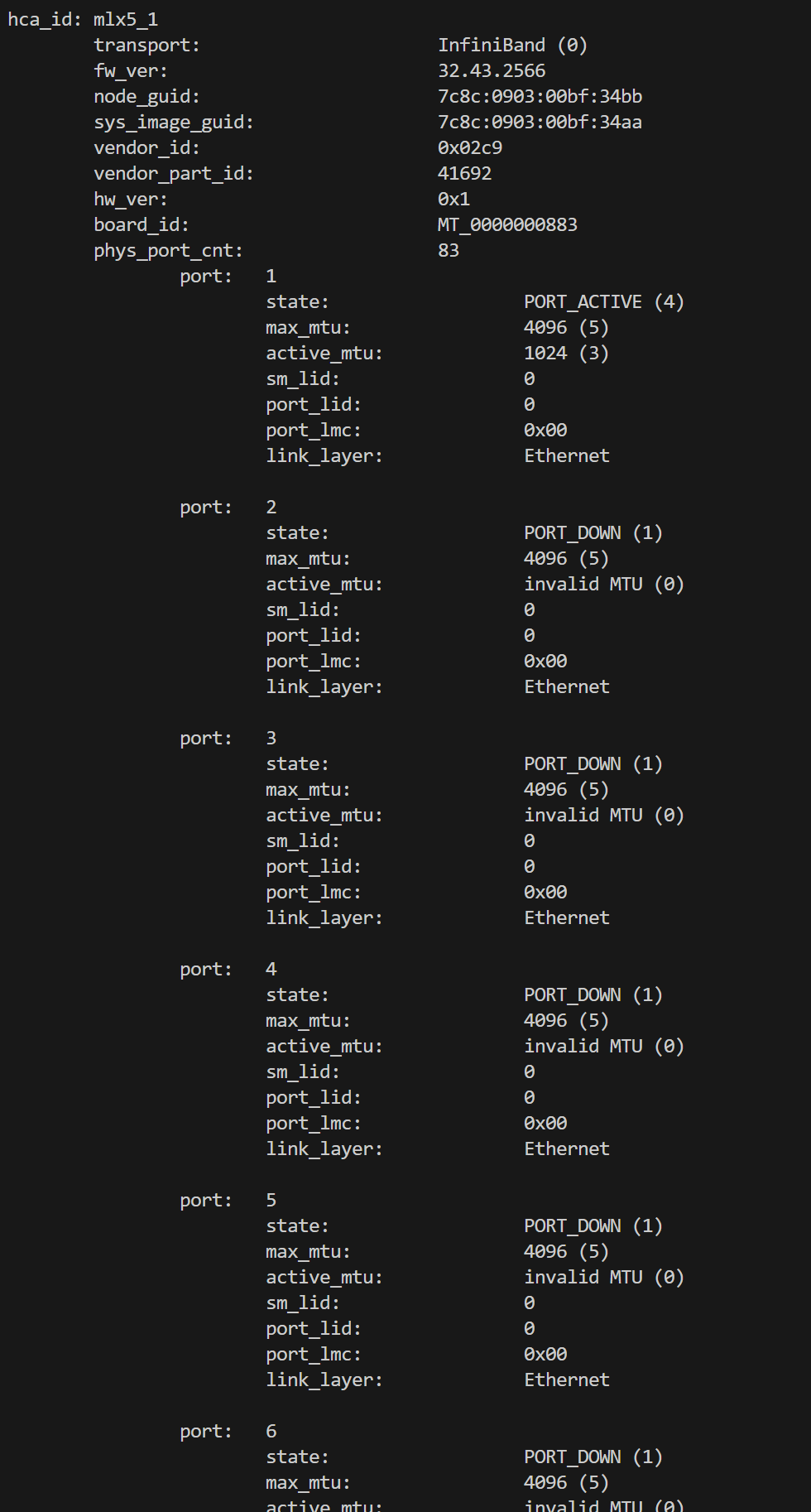

Another information that may help: when I tried ibv_devinfo in BF3, it shows some wired output for mlx5_0 and mlx5_1:
*very many phys_ports, totally 83 for mlx5_0 and mlx5_1.

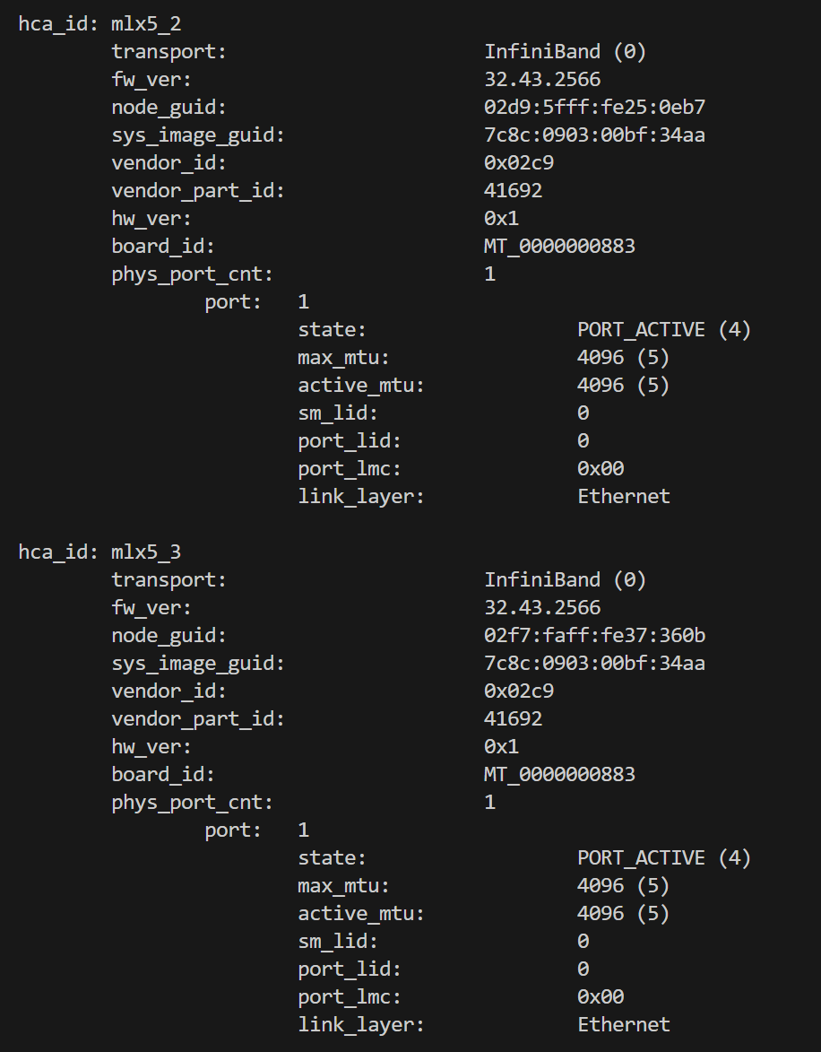

But for mlx5_2 and mlx5_3, they looks normal:

1.As we can see the error “Operation not permitted” while using mlx5_2/mlx5_3, please try to add the “–allow-run-as-root” follows “mpirun”.
2.Based on other error messages, this seems a fw issue, please try to upgrade the FW version from 32.43.2566 to 32.43.3608(or newer) and try again.
3.Regarding the mlx5_1 contains 83 devices under ibv_devinfo command output, I think this might be the SF(sub-function) device of this PF port inside your DPU arm OS, could you help to check the PF’s configuration inside your DPU OS?
