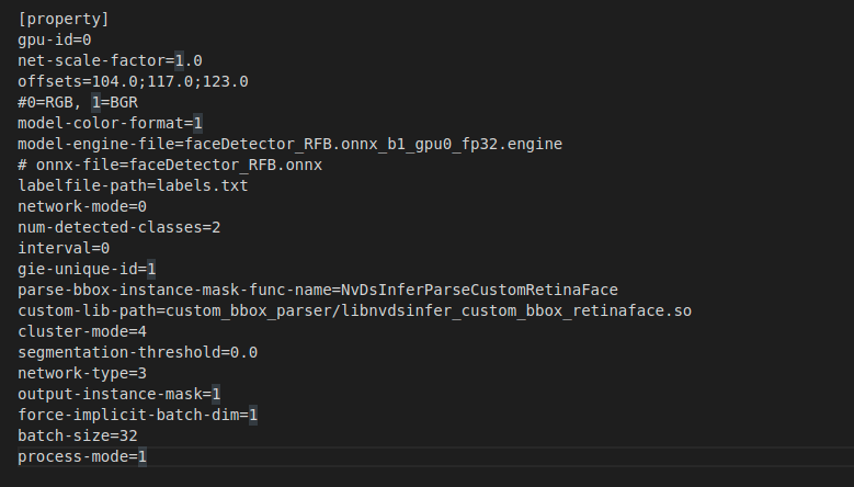

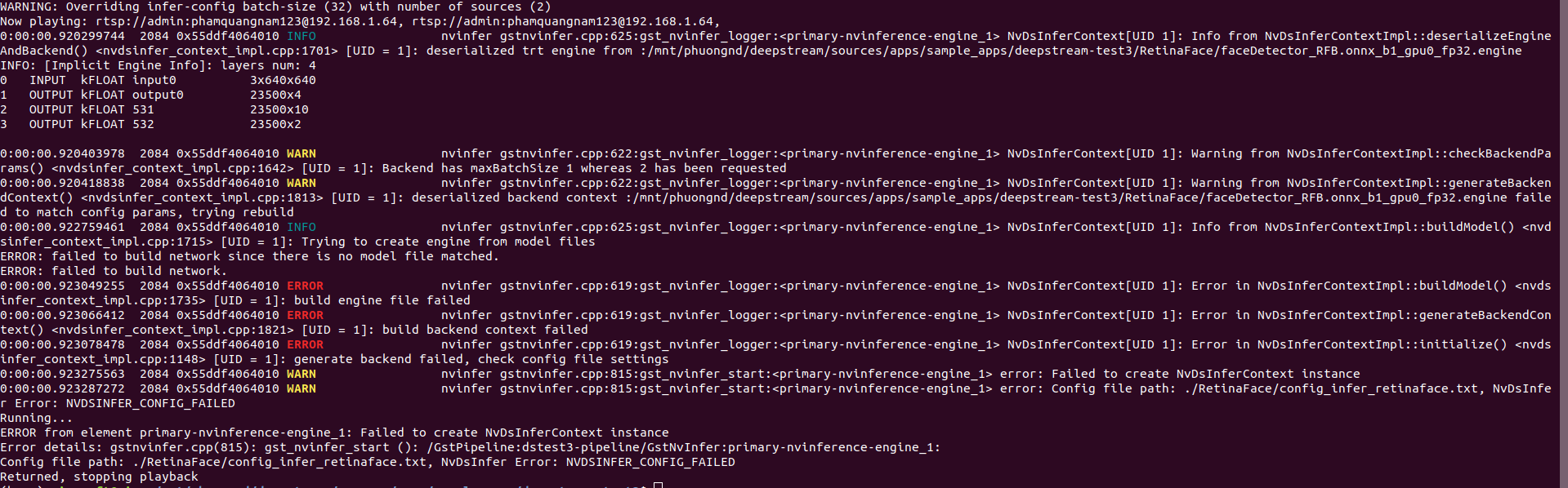

Im following deepstream-test3 example to build face detection system. I changed default model to face detection model in config path. When i run only rtsp source it work well but i add another rtsp source it raise error in below.
this is config file.
I dont know that why. How can i solve it? please.
Where did you get the engine file? From the name of the engine file, the batch size is 1, but the config file set the batch size as 32. Does your model support explicit batch size or implicit batch size? Seems the engine you are using can only support batch size 1 but nvinfer required batch size 2 capability. What is your nvstreammux batch size for the two rtsp sources? Can you try to change the batch size to 1 in your nvinfer config file?
Hi Chen.
You right, i builded engine file again witch batch size as 32 and it work well.
Thanks a lot.
