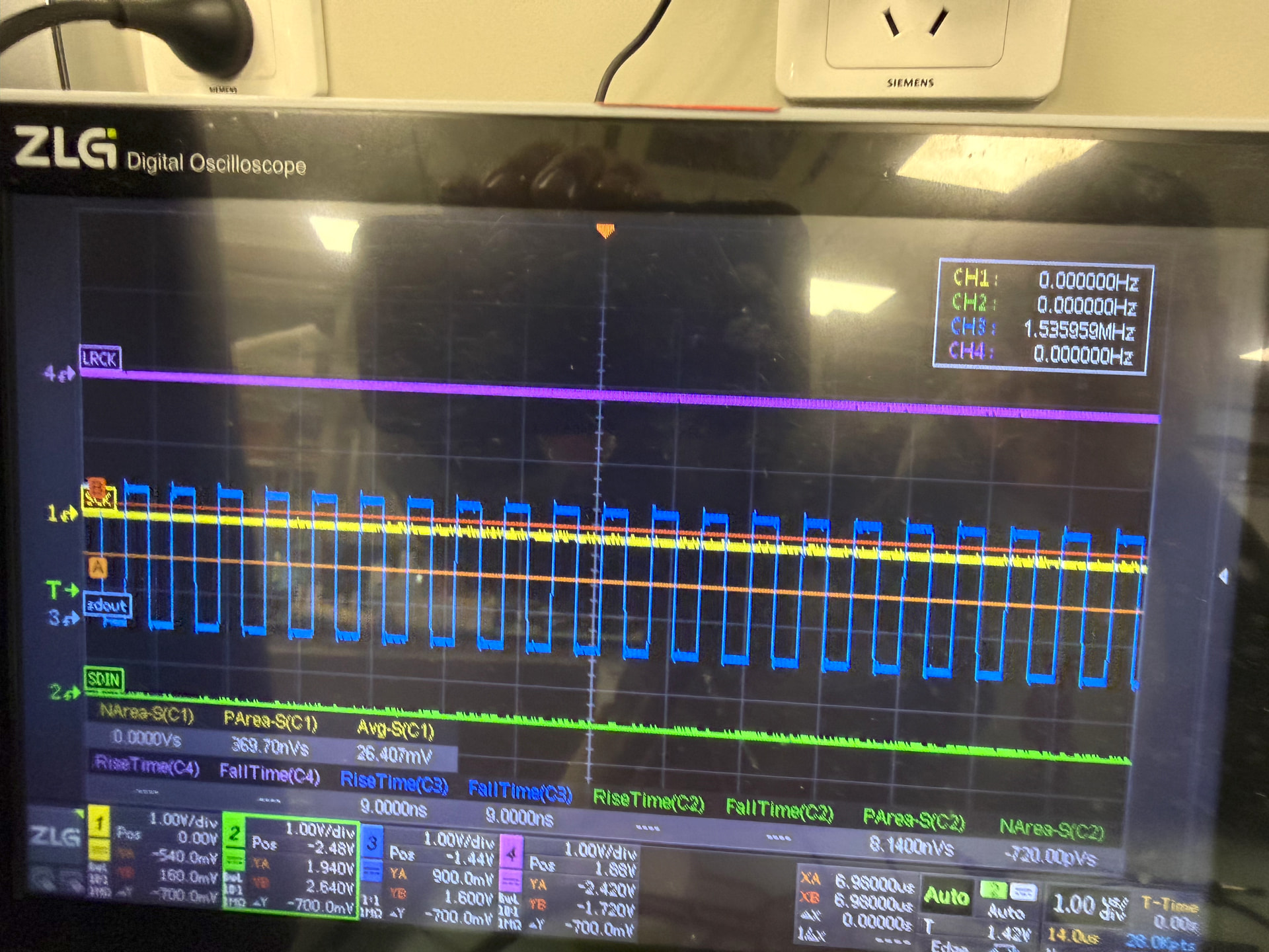

I tried to test the i2s with this command, and found that the waveform is as above, and the sck has a 1.53MHZ square wave. During this period, the LRCK maintains a high level, and other waveforms do not exist. Is this normal? Now I play the sound with this effect,

I also have a question. Now I see that after modifying a CONFIG_TEGRA_DPCM macro in the code, I couldn’t find where it is configured in the code. I tried to skip this macro in the code, assuming it has a default definition. After compiling and flashing, I found that the current SCK always has a waveform at 1.53MHz, LRCK always has a square wave at 24.33kHz, but SDOUT still has no waveform during playback.
The connections on your side looks fine. You don’t need to do CONFIG_TEGRA_DPCM macro change. As per the speaker-test command I have provided previously, the SCLK at 1.53MHz is right value. But LRCK looks odd which should be set at 48KHz which is the sampling rate we are playing on codec.

Hi:
The above is the measured waveform, including the captured log, after executing the command speaker test - D hw: 1,0- r 48000- c 2- F S16_LE - t sine - f 1000. It can be seen that the sdk is 1.53MHZ and the LRCK is 245KHZ. It seems that there is still a problem. At present, there is no idea about this place.
