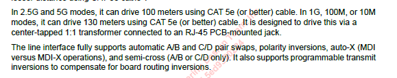

I think I found the answer:
Can you confirm? I propose using the HX5062NL, can you confirm if the approved magnetics when using the suggested AQR113C for 10GbE speeds is like this Pulse Electronics HX5062NL https://productfinder.pulseeng.com/product/HX5062NL
Please refer to the SCL in DLC for supported devices. For other ones that are not in the SCL, customer is responsible for handling that.
thank you. For AQR113C, the chip listed in the SCL, i found in the AQR113C’s reference design that the magnetics look like this:
I will begin searching for a magnetics chip of this format. I’m using a rugged RJ45 connector, and none of those that I have found have integrated magnetics, so I need to use a separate magnetics chip.
