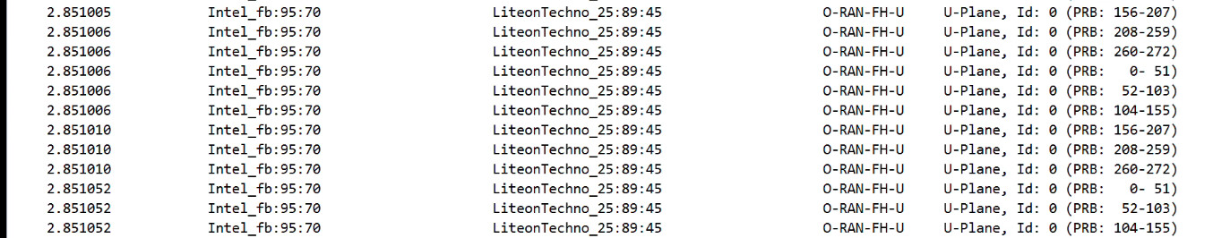

  3. I tried to change the SSB and PointA arfcn and UL/DL PRB to 133 and observe from the highPHY log some information:
  • [DRV.PUSCH] static_params.nMaxPrb: 273
  • [DRV.API] Update cell: mplane_id=5 dl_grid_sz=133
  • [DRV.API] Update cell: mplane_id=5 ul_grid_sz=133
    But the UP for DL still contains 273 PRB:
    What should I do to make DL UP send only 133 PRB?
Thank you

Hi @thanhlong_le ,
1. Can you elaborate more how to change the bandwidth to 50MHz? Forget to mention but I am using cuBB version 24-1, does it matter? Should I change to 24-2?
The ASDK version does not matter.
2. In my case, I only need to change the OAI configuration to 50MHz?
That is correct.
Please let us know if you were able to resolve this issue on your setup.
