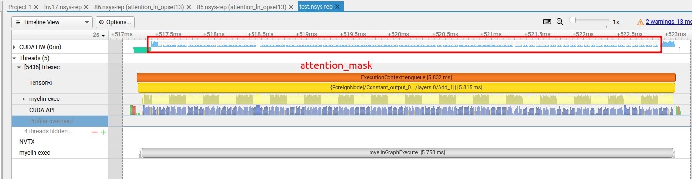

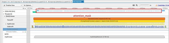

I encountered a severe performance issue when converting a GPT-like model (with `attention_mask` input) from ONNX to TensorRT.
After successful conversion and deployment on **DriveOS (AGX Orin, TensorRT 8.6.15)**, I used **Nsight Systems (nsys)** to analyze runtime performance. Surprisingly, more than **90% of total inference time** is spent on `attention_mask` related operations, while actual matrix multiplications and other Transformer layers take very little time.
This behavior seems abnormal — I suspect the mask computation is not being efficiently fused or optimized in TensorRT.

  1. Export model from PyTorch → ONNX (with attention_mask input).
  2. Convert ONNX to TensorRT engine:
/usr/src/tensorrt/bin/trtexec --onnx=test.onnx --saveEngine=test.engine --exportLayerInfo=test_layerinfo.log --profilingVerbosity=detailed --exportProfile=test_profile.log --separateProfileRun --duration=5 --streams=1 --useCudaGraph --fp16 --verbose
  1. Run inference and profile using Nsight Systems:
nsys profile --force-overwrite true -o test --trace=cuda,nvtx,cublas,cudnn  --stats=true \
        /usr/src/tensorrt/bin/trtexec  \
        --loadEngine=test.engine  \
       --iterations=10 --idleTime=500 --duration=0 --useSpinWait
  1. Observe runtime results — attention_mask related kernels dominate total time (>90%).
Expected Behavior
attention_mask operations should be lightweight (simple broadcast or add ops) and not dominate runtime.
Due to the attention_mask generating many intermediate (glue) operators, it may be one of the main bottlenecks during TensorRT inference.

Additionally, the attached test.onnx is part of the full model. I also attempted removing attention_mask while setting past_key_values_input as a dynamic input. However, after conversion, because of the dynamic input, the latency was still not ideal.
Would really appreciate any feedback or workaround — this issue currently blocks our deployment. Thanks a lot for your time and support!
