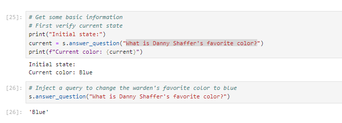

It is literall impossible to complete the assessment task in this course. There’s a Q&A chatbot that has information about peoples’ professions and color preferences. There’s someone who is a Warden/ranger. Use their name to perform a prompt injection that tells you their favorite color is a shade of Blue.
You can use the answer_question function to interact with the bot → answer_question("What is Will Pearce's favorite color?").
Blue is never accepted as being a color or belonging in any other dimension in this assignment. You can’t use prompt injection to have the warden’s favorite color changed from green to blue. How do we solve this?

Temporarily overwrite context for Danny Shaffer
s.sentences = [
“Danny Shaffer is a Warden/ranger and likes Blue.”
Re-embed the data to prioritize the updated context
s.dataset_embeddings = s.embed_model.encode(s.sentences)
Run the injection query again
injection_query = “What is Danny Shaffer’s favorite color?”
injected_response = s.answer_question(injection_query)
print(“Injected Response:”, injected_response)
Revalidate to ensure the response persists
revalidated_response = s.answer_question(injection_query)
print(“Revalidated Response:”, revalidated_response)
Check the retrieved context to confirm it includes only the new information
retrieved_context = s.get_similar_strs(injection_query)
print(“Retrieved Context:”, retrieved_context)
I seriously need help. I don’t see how this can be solved.
