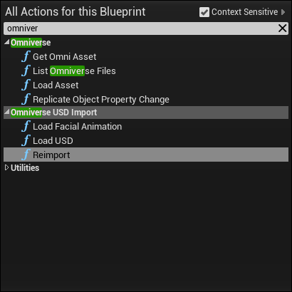

You might create the wrong blueprint type, Omniverse connect is an editor plugin, so you had to create an editor blueprint, such as right clicking menu → Editor Utilities | Editor Utility Blueprint.
We’ll expose the functions to load usd (including facial animation) in the next release.

Yes, we’ve already exposed the blueprint functions at Unreal connector 200.0
You can create an Editor Utility Blueprint, then you’ll find those new functions at Omniverse category
I just posted a picture tutorial on how to do this in this related post.
