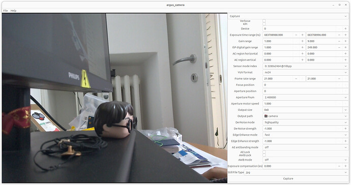

hello again, Jerry,
how can i set the exposure time manually? I can not adjust the exposure time by setting the mim and max at 683709000nm?
hello xi.che,
may I know what’s your sensor capability? what’s the actual use-case for settings min=max for the exposure time?
besides.. you’ll need to configure ae lock for setting the exposure time manually.
i think i have the imx219 sensor for nano :
acrual use-case: Compared to auto mode, I need to manually set a longer exposure time, for example: 600000000nm?
Where exactly is the AE Lock setting located in the interface? Could you describe it precisely?
hello xi.che,
is the setting within the exposure time range?
you may also run $ v4l2-ctl -d /dev/video0 --all for checking camera controls.
for instance,
                           gain 0x009a2009 (int64)  : min=16 max=357 step=1 default=16 value=26 flags=slider
                       exposure 0x009a200a (int64)  : min=13 max=683710 step=1 default=2495 value=8333 flags=slider
dear Jerry, i have
gain 0x009a2009 (int64) : min=16 max=171 step=1 default=16 value=77 flags=slider
exposure 0x009a200a (int64) : min=13 max=683710 step=1 default=2495 value=33330 flags=slider
but in argus_camera, the max gain is 10.625???
hello xi.che,
please note that, the value is rounded down to six decimal places. Usually set to 1.0, representing 1x gain.
hello , can you tell me how i can just set up the exposure time instead of gain ?
i can not change it manually? what is the Max exposure time i can set?
nothing change when i change the parameters in the software even with AELOCK checked?
hello xi.che,
here’s the max exposure time, max=683710 the unit is in microseconds, (i.e. us)
