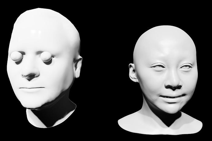

I used this method to get the eyes and lower jaw back into Blender. The Jaw/lower teeth work fine with a rotation constraint apply. However, the eyes translate (i.e. like popping forwards out of the head) rather than rotate. I noticed that this was the case in Audio2Face after the transfer of data as well. Do you have any advice on how to fix this?
