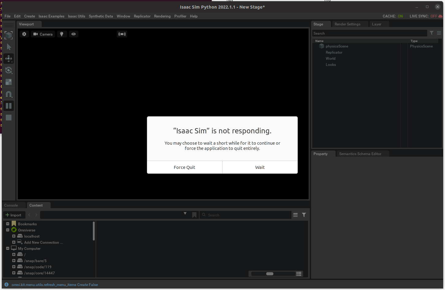

Hi @andrew_g I kept it running for around 20-30 minutes, however, still it remains stuck and forces to quit. I have also uploaded the screenshot where the freezing is observed in Isaac Sim 2022.1.

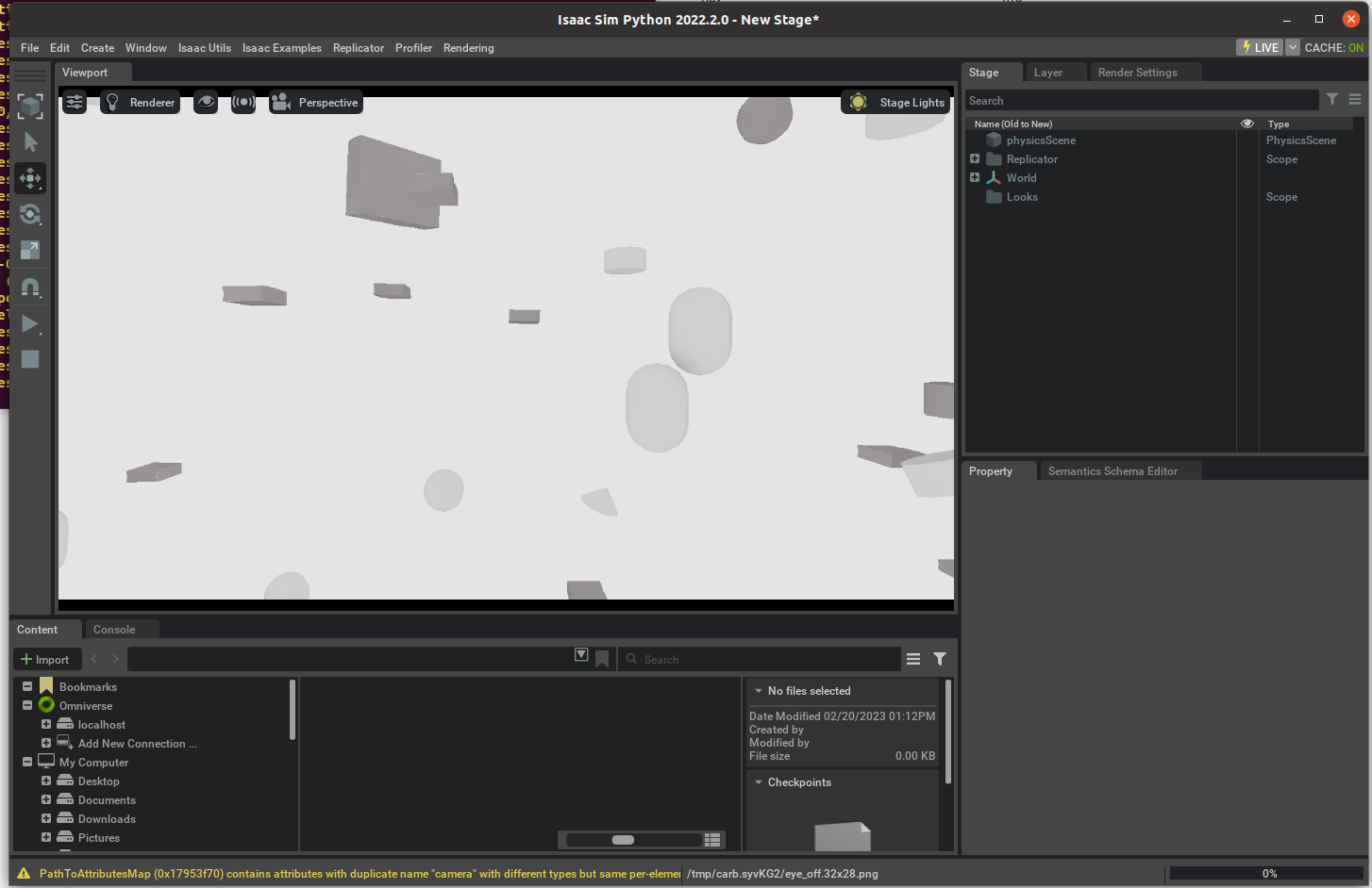

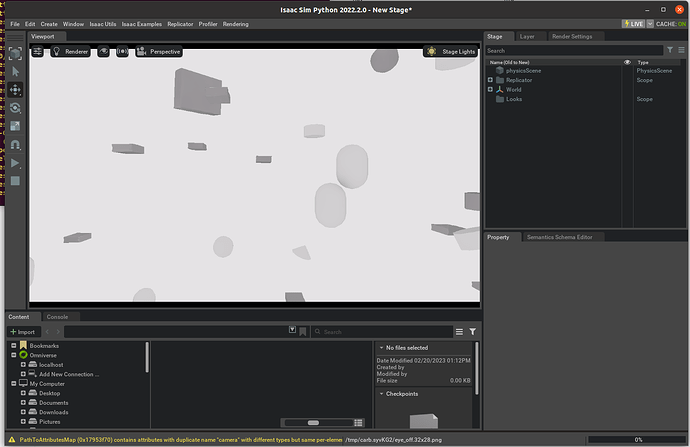

Additionally, I have also tried to run the same example in Isaac Sim 2022.2.0. Here as well the screen freezes after following errors and warnings:
Errors:
[Error] [omni.graph.core.plugin] /Replicator/SDGPipeline/OgnWritePrimAttribute_02: OmniGraph Error: WritePrimAttribute Error: ‘xformOp:orient’
(from compute() at line 237 in /home/labuser/.local/share/ov/pkg/isaac_sim-2022.2.0/extscache/omni.replicator.core-1.6.4+104.1.lx64.r.cp37/omni/replicator/core/ogn/python/_impl/nodes/OgnWritePrimAttribute.py)
Warnings:
[Warning] [omni.hydra.scene_delegate.plugin] cannot find xform op xformOp:rotateXYZ for /Replicator/Camera_Xform
[Warning] [carb.flatcache.plugin] UsdRelationship /Replicator/SDGPipeline/OgnGroup_04.inputs:prims has multiple targets, which is not supported
[Warning] [carb.flatcache.plugin] PathToAttributesMap (0x17e12890) contains attributes with duplicate name “camera” with different types but same per-element size. Data may become corrupted during request to move elements between buckets!
The screen freezes as soon as it tries to update:
Loading materials. Will generate data soon…
Start timestamp: 02/14/2023, 12:33:55
Starting dataset generation of 10 frames…
Starting MESH dataset generation of 5 frames…
I did try to debug in Isaac Sim 2022.2.0 and was able to find that it freezes on world.render() and rep.orchestrator.step(). Specifically, whenever omni.kit.app.get_app().update() is run within above mentioned methods. I have tried re-installing both the versions of Isaac Sim as well. However, the result remains unchanged.

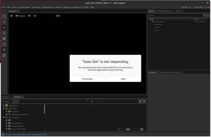

Hi @andrew_g I just tried what you had suggested in both versions 2022.1.1 and 2022.2.0. However, it is still stuck after waiting for around 10 minutes and forces to quit. Here are the screenshots for --num_dome 5 --num_mesh 0 :
Fig 1:
Fig 2:
For the --num_dome 0 --num_mesh 5 the output is similar to FIg 1 in both versions.

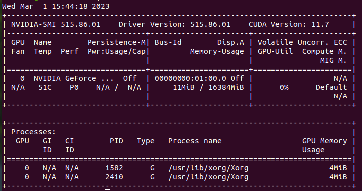

@deveshkumar21398 Our team is able to run the demos without any issues. Please run nvidia-smi while running the script and post the screenshot. This will help us identify more around whats happening
Sure, @mukundang please find below the screenshot of nvidia-smi.
Hi @deveshkumar21398, it looks like you don’t have the Nvidia driver properly installed. Can you follow Q1 on this guide to reinstall your driver?
Let me know if you have any trouble re-installing the driver
Troubleshooting.md (16.5 KB)
Hi @andrew_g thanks for your response. Which driver version need to be installed particularly and whether do I need to reinstall IsaacSim?
