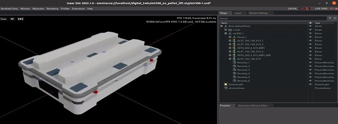

@rgasoto Hello! thank you for your reply.
I desperately need your help! I’ve been converting my models using Onshape as you suggested for a while now, and since I haven’t used Onshape before, it took me some time to learn how to use it.
After I successfully converted my model with onshape, the exciting thing is that I managed to make my robot model move on the plane. Next, I still plan to import the model into Robot Navigation, but the problem reappears, as shown in the figure below.
 ![error](https://global.discourse-cdn.com/nvidia/original/3X/6/6/6667e451e8e5c2924df69a925ad8bf1069c5e22d.png)
Could you please explain to me what these four errors mean? thank you very much!
Following your suggestion and the example of the Transporter robot, I modified the converted model into the following structure,
 ![interface](https://global.discourse-cdn.com/nvidia/original/3X/2/c/2c54541136cbf382a91a35176af6a8949f9c0c51.jpeg)
It has the same structure as the transporter example, but the result is not as expected.
Also, due to the complex structure of my model (actually on the Onshape structure list, I see it has 207 parts), I followed the transporter example and selected all but the six wheels as the chassis, as follows as shown
 ![chassis](https://global.discourse-cdn.com/nvidia/original/3X/9/8/989325c831f7a02b4a562afa221041103d67ce43.png)
Is this related to the error message?
Finally, the code sample I used is shown in the image below.
 ![code](https://global.discourse-cdn.com/nvidia/original/3X/a/c/accc2514999a40bce26d16923ad14c68165a9e86.png)
I really look forward to your reply, this problem has been bothering me for too long, I feel like I still can’t get to the point, thank you in advance for your reply!

for the wheel joints (Revolute\_6 and Revolute\_5 - from what I can see in the script), did you set up the joint Drive?
next, can you confirm that the robot is being found by the path defined in the final scene?
Some sort of video of the issue would help us understand what’s the cause of it.
