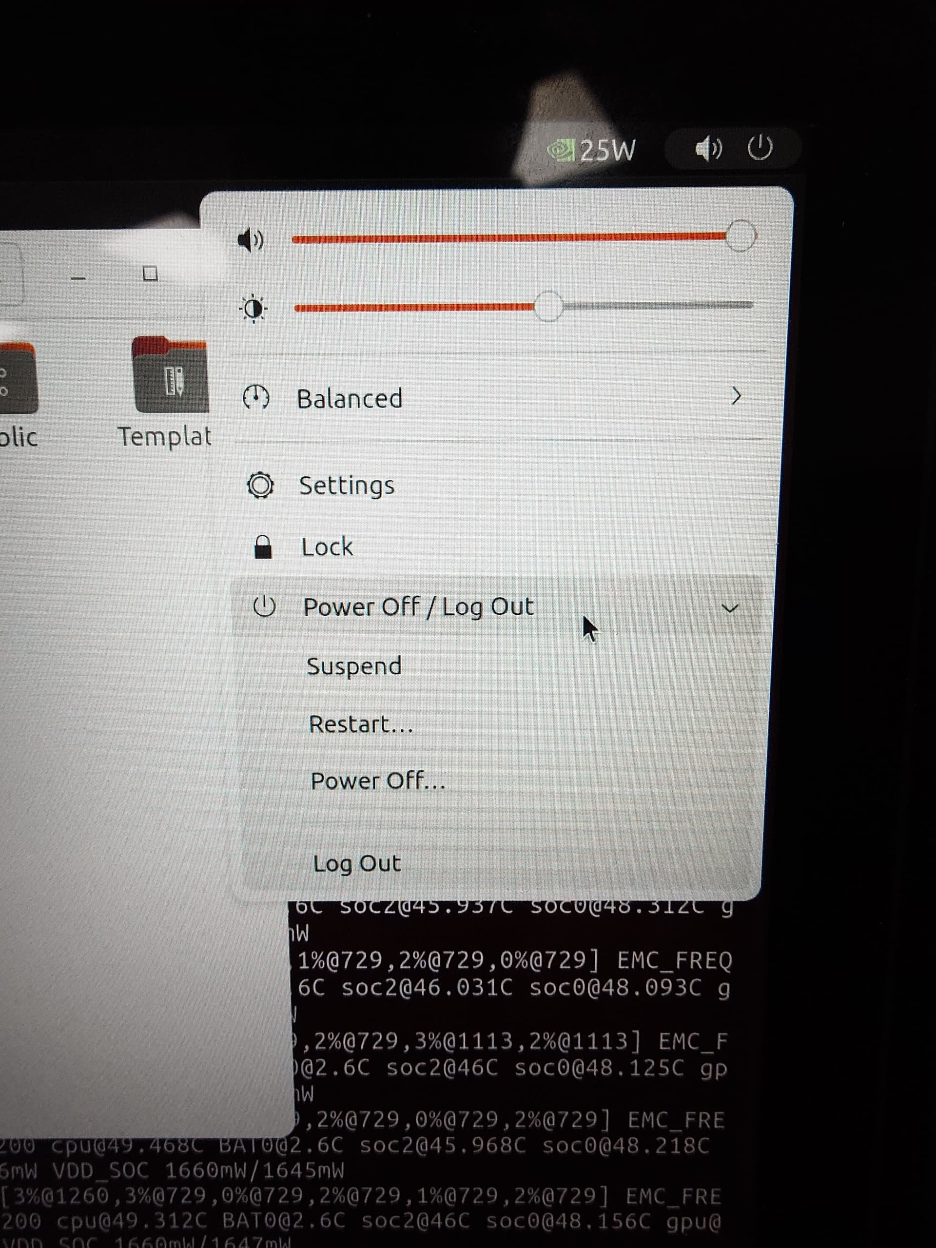

There is a “Suspend” option under “Power Off/Log Out,” which I used to test the suspend/resume action. Sometimes, the fan becomes loud when I press the power button to resume the system. This loud noise lasts for approximately 0 to 0.5 seconds. It’s not too long, but it is unusual.

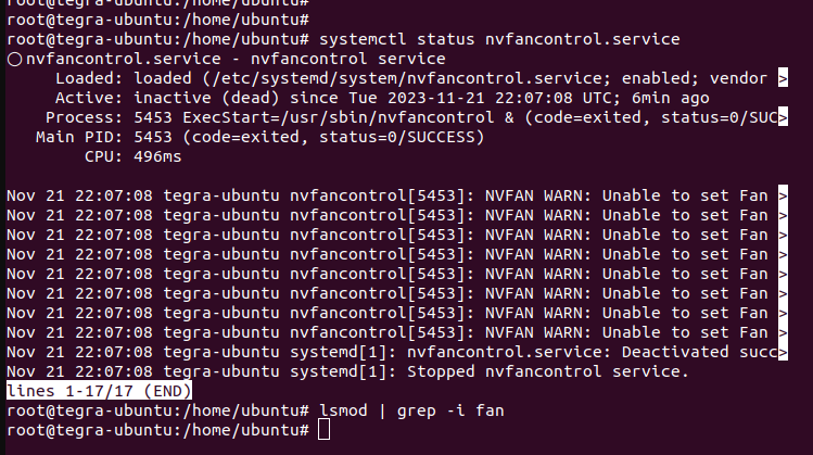

I have downloaded the Linux_for_Tegra and doing driver porting.
I noticed the fan became loud suddenly after resuming from suspend might not the driver issue.
Because I removed the pwm_fan driver and stopped the nvfancontrol.service. I could see the fan stopped, but after I suspended and resumed again, the fan started working. In the meantime, I’m 100% sure that my pwm_fan driver and nvfancontrol service are stopped.(This behavior is same as devkit.)
I think my main question is: Is there a reason the fan would still work even when the pwm_fan driver and nvfancontrol service are being stopped?
