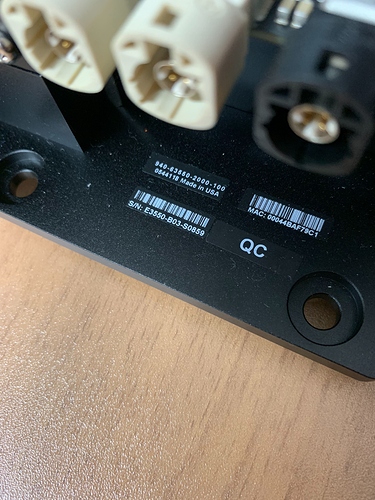

Could you please share the board serial number? Thanks.
Hi SteveNV,
Thanks for response.
Serial number is E3550-B03-S0859.
