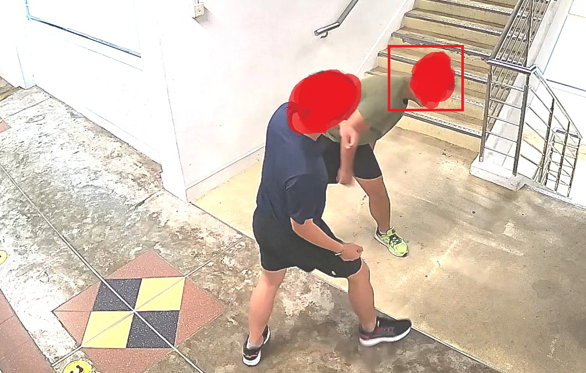

I am training fight detection.
My fight scenario is quite simple. Two person face to face and fight each other like in the image.
Normal activities are like walking or sitting.
Now the issue is when deploy the model, model detection are quite random. Even nobody in the scene, just background, is detected as fight. Sometimes fight and normal is flickering. Model didn’t learn like what I train.
If two persons face to face and attack each other is Fight. Normal is one or two person just randomly walking or sitting is normal activity.
