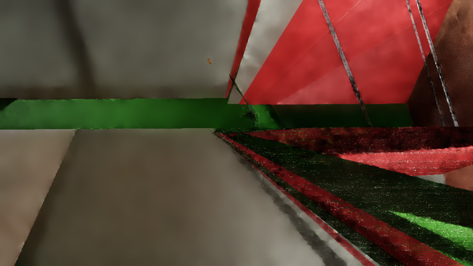

I’m using the Synthetic Data Recorder in IsaacSim 4.5 and the first two frames are quite reliably trash. Sometimes the animated people (omni.anim.people) are not loaded, sometimes it looks like the attached image.
I don’t use Subframes (and I don’t want to run Subframes for the whole sequence to only improve the first frames).
Would it be possible to warm up the render pipeline internally before publishing those images?

would it be possible to provide more information on your workflow? E.g. running in standalone, or from script editor/UI. Accessing data through sensors, annotators, or writers? Advancing the simulation through isaac sim world or through the timeline? Depening on how you run the pipeline you could wait for a few app updates whenever loading new assets/scenarios to make sure everything is loaded.
Regarding subframes, yes, the recorder will run with the given subframes the whole recording. The recorder is thought for quick UI based data collection/validation of various replicator writers and does not have any custom logic built in.

The recorder can only work with one camera (you can however use custom cameras if needed). For more flexible workflows it is recommended using a scripting approach, this way you can for example use the rt_subframes argument on the orchestrator.step() function which will render that given frame with more subframes which should fix the artifacts you are seeing.
