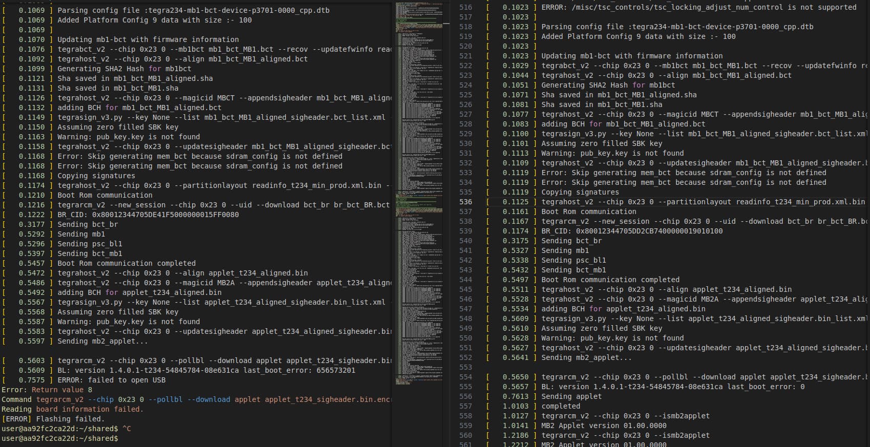

However, when I attempt to run flash.sh, the process fails with the error:
Error: failed to open USB
Interestingly, if I repeat the process but instead of using sudo reboot forced-recovery, I manually press the Recovery + Reset buttons, the device is listed correctly, and the flashing process proceeds successfully.

We are currently running JetPack version 5.1.3; however, I am unsure which version was applied following the update. I will attempt to reproduce the issue, although I believe it is not hardware-related since all procedures were performed on our custom PCB.
Initially, we were operating on an unknown JetPack version—presumably, one that was automatically updated after 5.1.3. The command sudo reboot --force-recovery successfully placed the device in recovery mode, but the flash script failed, as depicted in the attached image.
Subsequently, we reflashed the SoM by manually entering recovery mode using the buttons on our custom PCB (configured according to the manual’s instructions for the development kit). After this, we were able to execute the flash script successfully.
Once the board was flashed with JetPack 5.1.3, we again placed it into recovery mode using sudo reboot --force-recovery and successfully ran the flash.sh script.
Could you please advise on what steps I might take on my end to clarify this behavior?

I apologize for not expressing myself clearly. I do know how to reproduce the problem; however, I wanted to ask which commands I can execute to provide additional context on the issue—so that I can run everything both before and after the problem occurs.
Could you please advise which additional commands I might execute to gather more detailed system information? For example, aside from the operating system version, Jetpack version, and kernel version, are there other relevant details that would help diagnose the issue more thoroughly?
