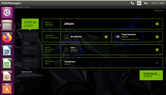

2.2 Last approach,
2.2.1 I run a virtual machine Ubuntu 16.04 on my host with VirtualBox(RAM>9, Storage = 60G).
2.2.2 Then follow simply the steps this. My linux installed automatically and I type “sdkmanager” in linux terminal and I got the following(as you can see the Jetson TX2 is detected and lsusb command in terminal detected it as well ( as It is already in force recovery mode).
  • Surprisingly, the steps for force recovery which is described in this does not work in my Jetson TX2. I followed this and it works(It is for TX1!!!, mine is TX2). (From working I mean, lsusb command in terminal shows Jetson! and also sdkmanager detect my device as Jetson TX2).

Technically Ubuntu 16.04 should work, but people who use this a rare. 18.04 is a known good working release. You can try with 16.04, and I would actually expect it to work, but my confidence is not nearly as high as with 18.04.
Using a VM is not supported, and is the cause of a very high number of flash failure issues. This does not mean you cannot get a VM to work, but you are far better off with something dual boot to a native Ubuntu 18.04. The main problem of getting a VM to work is that the recovery mode Jetson repeatedly disconnects and reconnects USB during the flash, but quite often the parent o/s of the host PC will intercept a reconnect and the VM will not have access to the USB after that. Every VM is different in how it deals with this, but there is nothing NVIDIA would be able to do about a host o/s blocking USB access after a reconnect. I want to emphasize that VMs have a “very high” failure rate during flash.
You could ask the VM help support about this, but if there is any way you can dual boot or otherwise use a native Ubuntu install, then it would be far easier in the long run.
