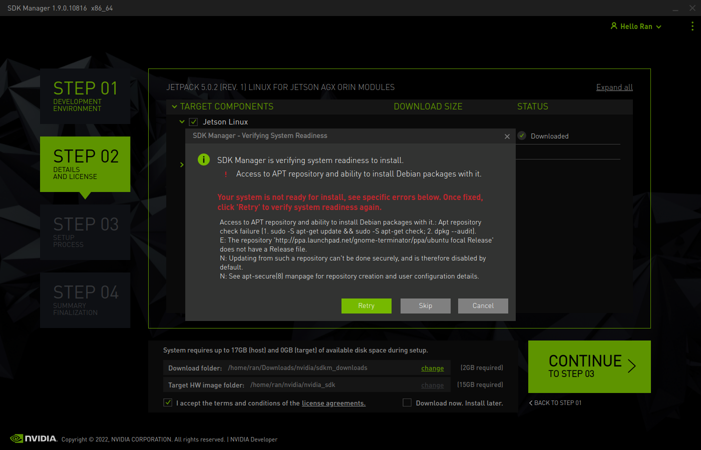

Flashing fails on Jetson AGX Orin,no release file
Im trying to flash a Jetson AGX Orin with the SDKManager using this guide:Jetson AGX Orin Developer Kit User Guide - Two Ways to Set Up Software | NVIDIA Developer.
After step 02 i get this error:
i made sure that the Jetson is launched in recovery mode
This is not the problem on whether jetson is in recovery mode or not. This error means some problem on your x86 host machine.
Apt-get update command probably returns some errors.
