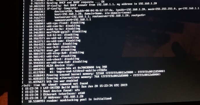

sudo ./flash.sh -N 192.168.1.20:/nfsroot orbitty eth0
And as a result I saw the following message on the host:
*** The target t210ref has been flashed successfully. ***
Make target nfsroot(192.168.1.20:/nfsroot) exported on the network and reset the board to boot
However, on the Jetson I saw:
and after a while:
How can make the target exported on the network?
What does it mean?

Just FYI, flash.sh uses only the USB connection to a Jetson in recovery mode. It’s called the driver package because in recovery mode the Jetson is a custom USB device understood only by a custom driver. JetPack is just a front end, and it uses the driver package for flash. Network addresses are only used when the driver package is completely done and no longer participating as a way to install packages. I haven’t used NFS as a rootfs source, but I think this is all it is…a substitute for the sample “rootfs/” subdirectory by naming an NFS location.
