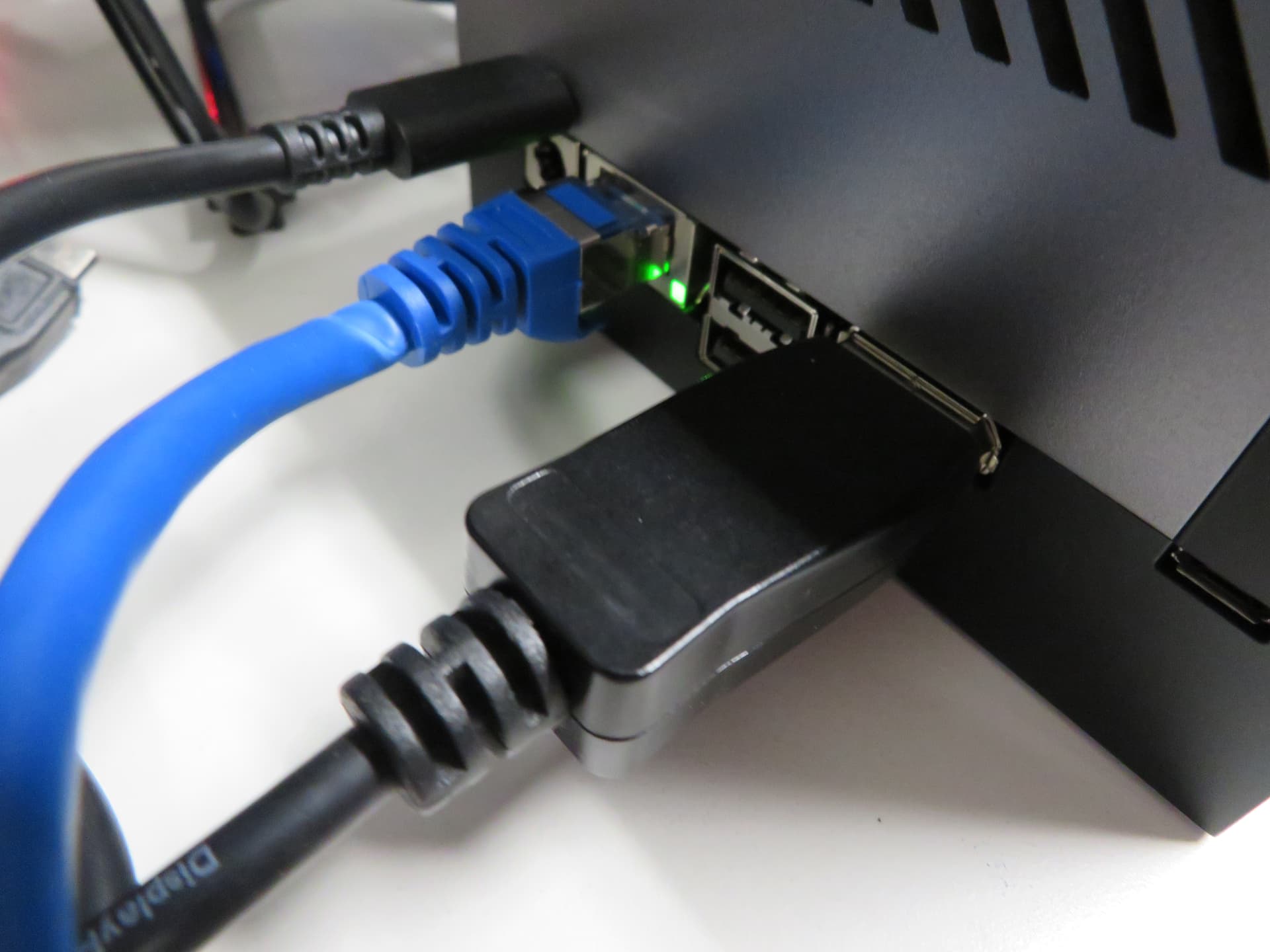

you have not even connect Type-C next to 40pin header for image flashing…
After multiple tries, we were able to flash the bare minimum JetPack 5.0.2. And fixed the flash.sh parameters that I missed, we were able to flash the kernel. However, we are still facing issues where the Jetson will not completely boot. It always gets stuck at a certain point:

Do you have detailed instructions on where the device tree blob needs to be copied to on the target?
Also, the Jetson AGX Orin dev kit does not have an HDMI port.
hello jtaghipour,
you may copy the device tree binary with scp utility. and, modify the extlinux.conf to specify the file path. reboot the system to make the changes take effect.
ya, my bad, there’s only DP port for AGX Orin.
