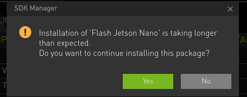

flash pegasus needs higher time than expected
this is one pic I capture from other forums , but I have the same problem similar to this pic
Dear @yang.liu1,
Is it jetson nano or DRIVE platform?
DRIVE platform
I have not screenshot my issue , But from the forums , I found one guy have similar case , though he is flashing Nano
but the resolution from that guy does not suitable to pegasus
could you give one resolution based on the pegasus platform ?

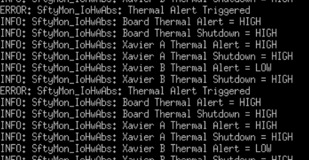

Yes. Firstly, please check if you have same issue ( thermal alert on aurix console) as in Flashing pegasus stucks on 99.9% - #7 by SivaRamaKrishnaNV
Let us know if you still face issue.
I do not know why , so so so many bugs , and i do not know how to fix it .
even do not know how to use it , why so expensive one hardware could not give one stable software version .
Yes, I have the same problem
  1. I turn off the NVIDIA pegasus , and turn off the host
  2. And directly connect the typeA2typeA cable , I could see
Dear @yang.liu1,
Thanks for confirming board status. As mentioned earlier, there is some interval gap before you see Thermal alert errors on aurix console. You need to set the board into recovery mode in that duration. The error indicates board is not in stable state. The shared link provides a work around to get the board back into normal state to be able to flash.

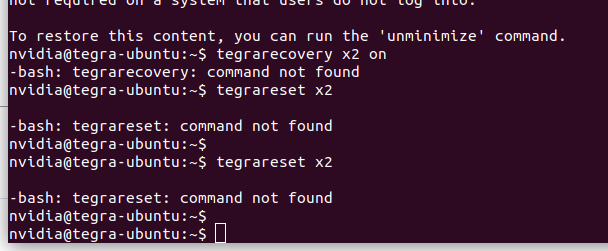

I have tried , but I could not type in any words into the command line , does there needs some other operation
need I config the minicom before input the
tegrarecovery x2 on
tegrareset x2
OR does these sentences need to executed from some other methods ?

Add another pic captured
It means after I type into the host command line :
sudo minicom -D /dev/ttyUSB3
after that , I could not type into any word , only could see info from the pegasus .
Dear @yang.liu1,
Connect to aurix console from host and poweoff and poweron the board by keeping the aurix session open. This should give enough room to enter the commands as soon as the target starts.
I type in words , but could not see any reaction
After turn off the power , thus I could type in so less words
but as the the phase I power on the target , I could not see any reaction when I type in words .

When I type in
tegrarecovery x2 on
tegrareset x2
I could see no reaction
But when I type in
tegrarecovery x2 off
tegrareset x2
I saw some new sentences showed in the image
Do you know how to configure my current target pegasus ?
Dear @yang.liu1,
To flash the target(xavier or pegasus) it has to be set into recovery mode. So run tegrarecovery x2 on && tegrareset x2on aurix and check if you see Nvidia Corp in output of lsusb on host after few seconds(like 10 sec). If it shows up, you are good to go with flashing. After flashing the target you need to turnoff the recovery mode of target. Hence you need to run tegrarecovery x2 off && tegrareset x2. All these are inherently taken care by sdkmanager. But as target is in unstable state, sdkmanager could not run tegrarecovery command which effects the flashing.
I think now you are able to run commands on aurix console before you hit Thermal alert warnings.
