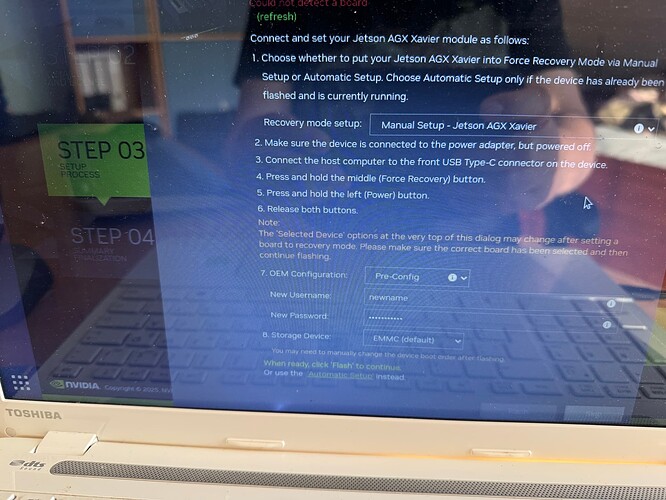

We have numerous AGX Xaviers that we are trying to reuse on a new project.
I’m using the SDK to flash to Jetpack 5.1.5 and all goes well apart from one very annoying point.
Despite doing a manual install and defining a new username and password the old user name (and sometimes unknown password) appear after flashing.

Only the old user name appears on the login screen. The new userid I requested via manual setup is not being created. I now have the password to this device and can see that the home dircetory for the old user was created when I flashed. I ask for a user called “newname” and get “one”. I would really like to do the equivalent of a “factory reset” and set these devices to Jetpack 5.1.5 with new userids.

The flash, despite saying successful, has some errors in the logs. Looks like some partitions are not being updated. Old /home and /etc . I have attached the logs and a photo. When the system boot I see Jetson uefi frimware from 2025-03-04.

I’m flashing to the eMMC. I have cleared down the LInux_for_Tegra directory several time and the username that appears is not one I ever configured. Just tried a second device and flashing the APP partition works without issue. It’s some specific about this device. I checked and there is no SD card or NVME in/on it.
What confuses me is it keeps saying sucessfully flashed but nothing has changed in the APP partition. Its the same if i restore a backup from another machine to this device using the flash.sh command .
How can I see if I’m flashing to the wrong boot disk?
I suppose this is one of the issues you get when you don’t know what the prior user did with the hardware.
Problem solved - this device was unique - there was a NVME card in it - I had been flashing the eMMC and booting from NVME.
