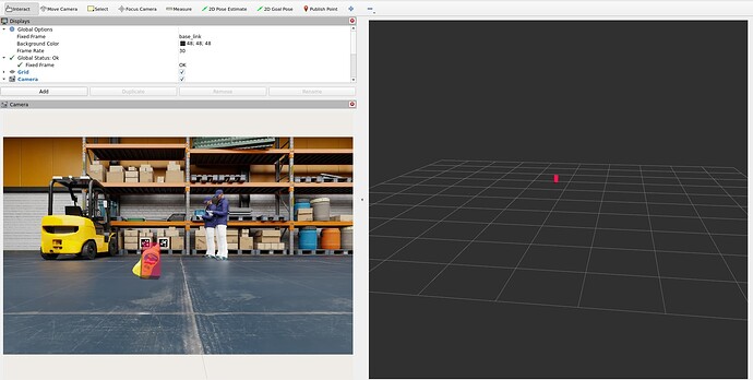

  1. According to the note in documentation I gave the object “006_mustard_bottle” which is among the object classes for DETR. I ran this using the below command
ros2 launch isaac_ros_foundationpose isaac_ros_foundationpose_isaac_sim.launch.py mesh_file_path:=/workspaces/isaac_ros-dev/isaac_ros_assets/isaac_ros_foundationpose/Mustard/textured_simple.obj  texture_path:=/workspaces/isaac_ros-dev/isaac_ros_assets/isaac_ros_foundationpose/Mustard/texture_map.png
and I got below results which doesn’t seem right, can you kindly highlight what could be the problem ( I got the assets through isaac_ros_examples - isaac_ros_foundationpose — isaac_ros_docs documentation Step4 for Rosbag)

Can you provide more debugging information, including the visualization of depth, bounding box, and mask?

  1. First is more of conceptual, as in documentation here Isaac ROS Pose Estimation — isaac_ros_docs documentation it is mentioned that Foundation pose works on novel objects without retraining. But in the setup here Tutorial for FoundationPose with Isaac Sim — isaac_ros_docs documentation it is confirmed that at the backend its using ESS depth estimation as well as DETR, which doesn’t work on novel object and would require retraining, so is it true that foundation pose end to end can’t work on novel objects ?
  2. For the working on trained objects. in the detr_grasp model i.e. “006_mustard_bottle” Ref. SyntheticaDETR | NVIDIA NGC) i shared the sample picture of detected pose which I didn’t get properly. asssets to run that was obtained from ( I got the assets through isaac_ros_examples - isaac_ros_foundationpose — isaac_ros_docs documentation Step4 for Rosbag)
