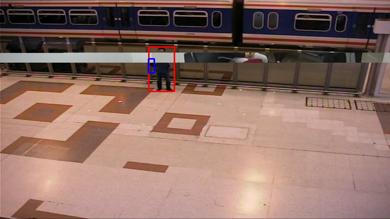

Frames gets corrupted when extracting it from buffer in the appsink
I am running Deepstream 5.1 on Dell G5 15 the GPU is GTX 1650ti the OS is Ubuntu 18.04.5LTS tensorrt version 7.2.3.4 GPU Driver 460.39 CUDA version 11.2
I have a pipeline that is like this:
uridecodebin->nvstreammux->nvinfer->nvtracker->nvdsanalytics->nvvideoconverter->queue->appsink
I read the buffer in the appsink and extract the meta data and frames batch to do further processing on them this is the code I read the images and the metadata with.

where g_imagesBatch is a global std::vector<cv::Mat> and g_personsBatch is a global std::vector<std::vector<cv::Rect>>
I lock a mutex before writing to the g_imagesBatch and unlock it after finishing.
The problem is some frames in say source number 0 say 2 frames in 3000 frames comes mixed with other frames from source number 1 and I don’t know why is this happening please provide some help if you know a solution.
How many sources do you have?
What do you mean by this description? How did you know source 0 frames are mixed with source 1 frames?
Now I have 2 sources I mean for example the frame of source 0 have a part from the frame of source 1. This is a picture of the corrupted frame of source 0.
Can you provide a complete code and configuration which we can reproduce the problem in our side?
