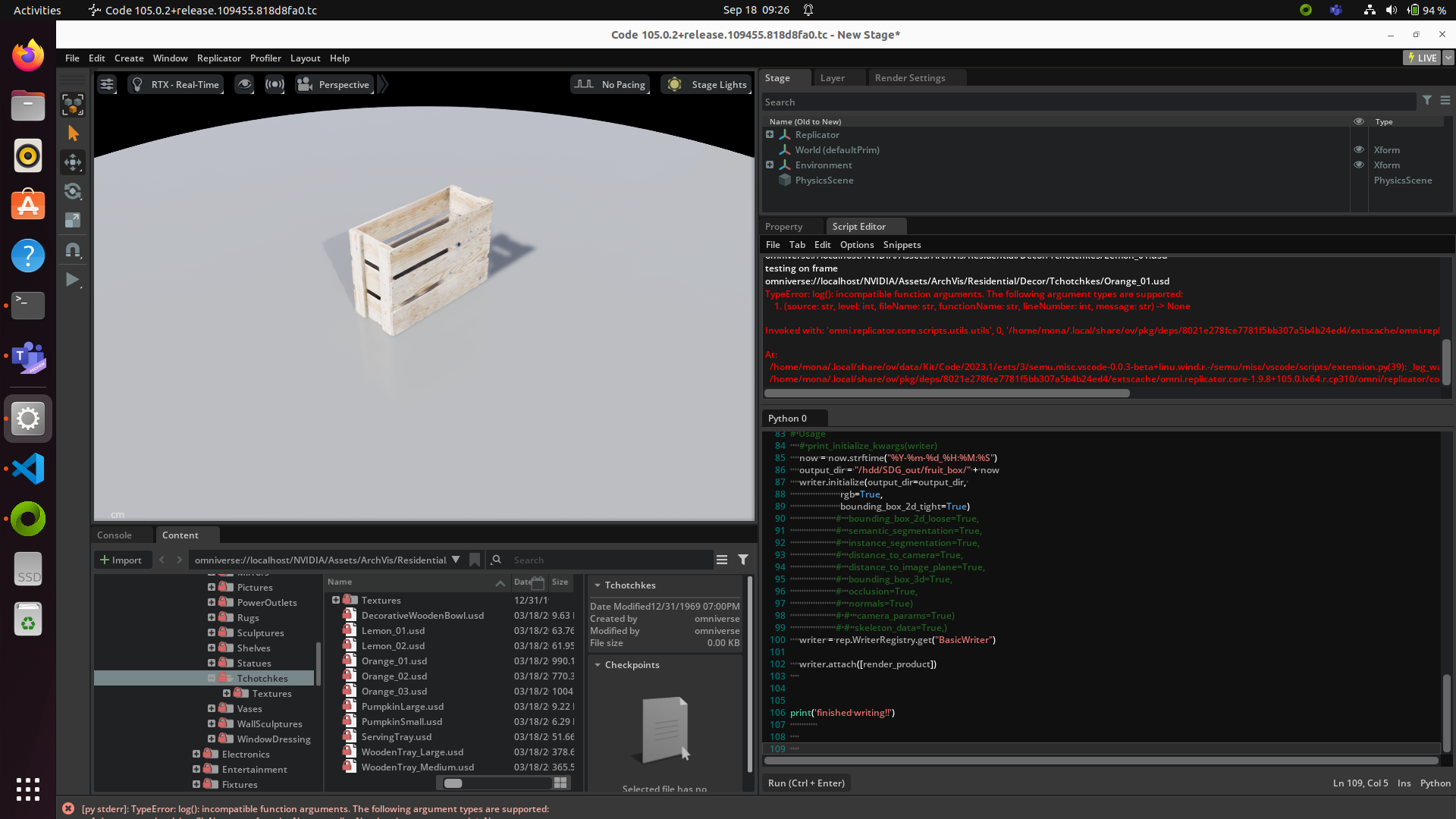

Fruitbox in Code 2023.1.1 from VSCode Embedded Plugin
Here’s the code:

When I run it from VSCode Embedded, I get this error:
[4:29:13 PM] executing at 127.0.0.1:8226...
Overriding function {sphere_lights} for replicator.randomizer.
testing on frame
omniverse://localhost/NVIDIA/Assets/ArchVis/Residential/Food/Fruit/Apple.usd
testing on frame
omniverse://localhost/NVIDIA/Assets/ArchVis/Residential/Food/Fruit/Avocado01.usd
testing on frame
omniverse://localhost/NVIDIA/Assets/ArchVis/Residential/Food/Fruit/Kiwi01.usd
testing on frame
omniverse://localhost/NVIDIA/Assets/ArchVis/Residential/Food/Fruit/Lime01.usd
testing on frame
omniverse://localhost/NVIDIA/Assets/ArchVis/Residential/Food/Fruit/Lychee01.usd
testing on frame
omniverse://localhost/NVIDIA/Assets/ArchVis/Residential/Food/Fruit/Pomegranate01.usd
testing on frame
omniverse://localhost/NVIDIA/Assets/ArchVis/Residential/Food/Vegetables/RedOnion.usd
testing on frame
omniverse://localhost/NVIDIA/Assets/ArchVis/Residential/Decor/Tchotchkes/Lemon_01.usd
testing on frame
omniverse://localhost/NVIDIA/Assets/ArchVis/Residential/Decor/Tchotchkes/Orange_01.usd
Traceback (most recent call last) line 126
  File "/home/mona/.local/share/ov/pkg/deps/8021e278fce7781f5bb307a5b4b24ed4/extscache/omni.replicator.core-1.9.8+105.0.lx64.r.cp310/omni/replicator/core/scripts/writers.py", line 344, in attach
    WriterRegistry.attach(self, render_products)
  File "/home/mona/.local/share/ov/pkg/deps/8021e278fce7781f5bb307a5b4b24ed4/extscache/omni.replicator.core-1.9.8+105.0.lx64.r.cp310/omni/replicator/core/scripts/writers.py", line 485, in attach
    writer_node = cls._attach(writer, active_writer_id, render_products, **combined_kwargs)
  File "/home/mona/.local/share/ov/pkg/deps/8021e278fce7781f5bb307a5b4b24ed4/extscache/omni.replicator.core-1.9.8+105.0.lx64.r.cp310/omni/replicator/core/scripts/writers.py", line 637, in _attach
    dispatcher_node.get_attribute("outputs:exec").get_downstream_connections()[0].get_node()
IndexError: list index out of range
During handling of the above exception, another exception occurred:
  File "/home/mona/.local/share/ov/data/Kit/Code/2023.1/exts/3/semu.misc.vscode-0.0.3-beta+linu.wind.r.-/semu/misc/vscode/scripts/extension.py", line 331, in _exec_code_async
    result = eval(code, self._globals, self._locals)
  File "<string>", line 6
  File "/home/mona/.local/share/ov/pkg/deps/53eecfb6325f36fca7f76796eab8a71c/python/lib/python3.10/contextlib.py", line 153, in __exit__
    self.gen.throw(typ, value, traceback)
  File "/home/mona/.local/share/ov/pkg/deps/8021e278fce7781f5bb307a5b4b24ed4/extscache/omni.replicator.core-1.9.8+105.0.lx64.r.cp310/omni/replicator/core/scripts/utils/utils.py", line 116, in new_layer
    carb.log_warn(e)
  File "/home/mona/.local/share/ov/data/Kit/Code/2023.1/exts/3/semu.misc.vscode-0.0.3-beta+linu.wind.r.-/semu/misc/vscode/scripts/extension.py", line 39, in _log_warn
    carb.log(mod, carb.logging.LEVEL_WARN, file, func, lno, msg)
TypeError: log(): incompatible function arguments. The following argument types are supported:
    1. (source: str, level: int, fileName: str, functionName: str, lineNumber: int, message: str) -> None
Invoked with: 'omni.replicator.core.scripts.utils.utils', 0, '/home/mona/.local/share/ov/pkg/deps/8021e278fce7781f5bb307a5b4b24ed4/extscache/omni.replicator.core-1.9.8+105.0.lx64.r.cp310/omni/replicator/core/scripts/utils/utils.py', 'new_layer', 116, IndexError('list index out of range')
Running the code below in Script Editor yields similar error. Any update on how to fix this in Omniverse Code 2023.1.1?

The error:
Also to add, when I click run, I see this
and when I click on preview and change camera from perspective to camera, I see this
However, clicking on replicator → start yields no result
that’s odd, i ran the code and there was no error in Code 2023.1.1?
