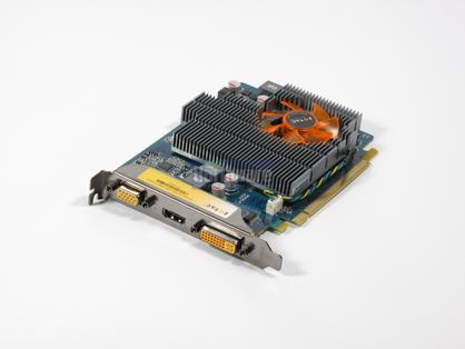

Is anyone willing to “take a bullet for the team”, buy a GT240 card and post the deviceQuery? I think the single-slot Zotac GT 240 cards are particularly interesting as upfit GPUs for some 1U compute nodes:
Not requiring supplemental power is also a plus. The only downside with the current Zotac models is having to choose between 1GB GDDR3 or 512MB GDDR5.
The bandwidth gap between GDDR3 and GDRR5 is pretty significant. I would go for a 1GB GDDR5 model from another vendor.
Who has 1GB GDDR5 single-slot? The only real reason I see to get these for CUDA is to fit them in places a GT200-series GPU won’t go. If you have the room, go with a GTX 260 for ~$40 more and get compute level 1.3. We have a number of (well-funded) department heads who would love to be able to upgrade their existing cluster compute nodes for CUDA.
Palit are the only company with a release day 1Gb GDDR5 part, and it is a dual slot card…
