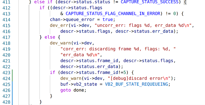

I use following v4l2-ctrl to get raw data.
command:
v4l2-ctl -d /dev/video0 --set-fmt-video=width=1920,height=1080,pixelformat=BA12 --set-ctrl=bypass_mode=0,hdr_enable=1,sensor_mode=1 --stream-mmap --stream-count=1 --stream-to=ov1080.raw
But it has CHANSEL_NOMATCH error, I check Jetson TX2 Camera BringUp - eLinux.org, And
data:0x00000589 mean that no_match, LS, NvCsiDataType_RAW12
[ 47.187753] [ar0221_power_on][426] …
[ 47.271597] [vi5_channel_start_streaming] chan->bypass=0
[ 47.307394] ar0221_set_mode …, mode=1
[ 47.307510] [ar0221_write_table][207] …
[ 47.317610] [ar0221_start_streaming][560] …
[ 47.317729] [ar0221_write_table][207] …
[ 47.360612] tegra194-vi5 15c10000.vi: corr_err: discarding frame 1, flags: 0, err_data 131072
[ 47.360798] tegra194-vi5 15c10000.vi: [debug]discard error
[ 47.393897] tegra194-vi5 15c10000.vi: corr_err: discarding frame 2, flags: 0, err_data 131072
[ 47.394082] tegra194-vi5 15c10000.vi: [debug]discard error
[ 47.427229] tegra194-vi5 15c10000.vi: corr_err: discarding frame 3, flags: 0, err_data 131072
[ 47.427419] tegra194-vi5 15c10000.vi: [debug]discard error
[ 47.460591] tegra194-vi5 15c10000.vi: corr_err: discarding frame 4, flags: 0, err_data 131072
[ 47.460809] tegra194-vi5 15c10000.vi: [debug]discard error
[ 47.493904] tegra194-vi5 15c10000.vi: corr_err: discarding frame 5, flags: 0, err_data 131072
[ 47.527230] tegra194-vi5 15c10000.vi: corr_err: discarding frame 6, flags: 0, err_data 131072
[ 47.527442] tegra194-vi5 15c10000.vi: [debug]discard error
[ 47.560584] tegra194-vi5 15c10000.vi: corr_err: discarding frame 7, flags: 0, err_data 131072
[ 47.560802] tegra194-vi5 15c10000.vi: [debug]discard error
[ 47.593901] tegra194-vi5 15c10000.vi: corr_err: discarding frame 8, flags: 0, err_data 131072
[ 47.594090] tegra194-vi5 15c10000.vi: [debug]discard error
[ 47.594243] [ar0221_stop_streaming][572] …
[ 47.594326] [ar0221_write_table][207] …
[ 47.646524] [ar0221_power_off][448] …

but when I disable the error data of vi5_capture_dequeue() of vi5_fops.c, like this:
I can get a frame raw data, it size is 4147200 Bytes.
So,
- How to locate in the source code where the CHANSEL_NOMATCH error occurs?
- How to get sensor output data from frame start to frame end?
- About this error, please give me some advise to fix it?
Thank you!
