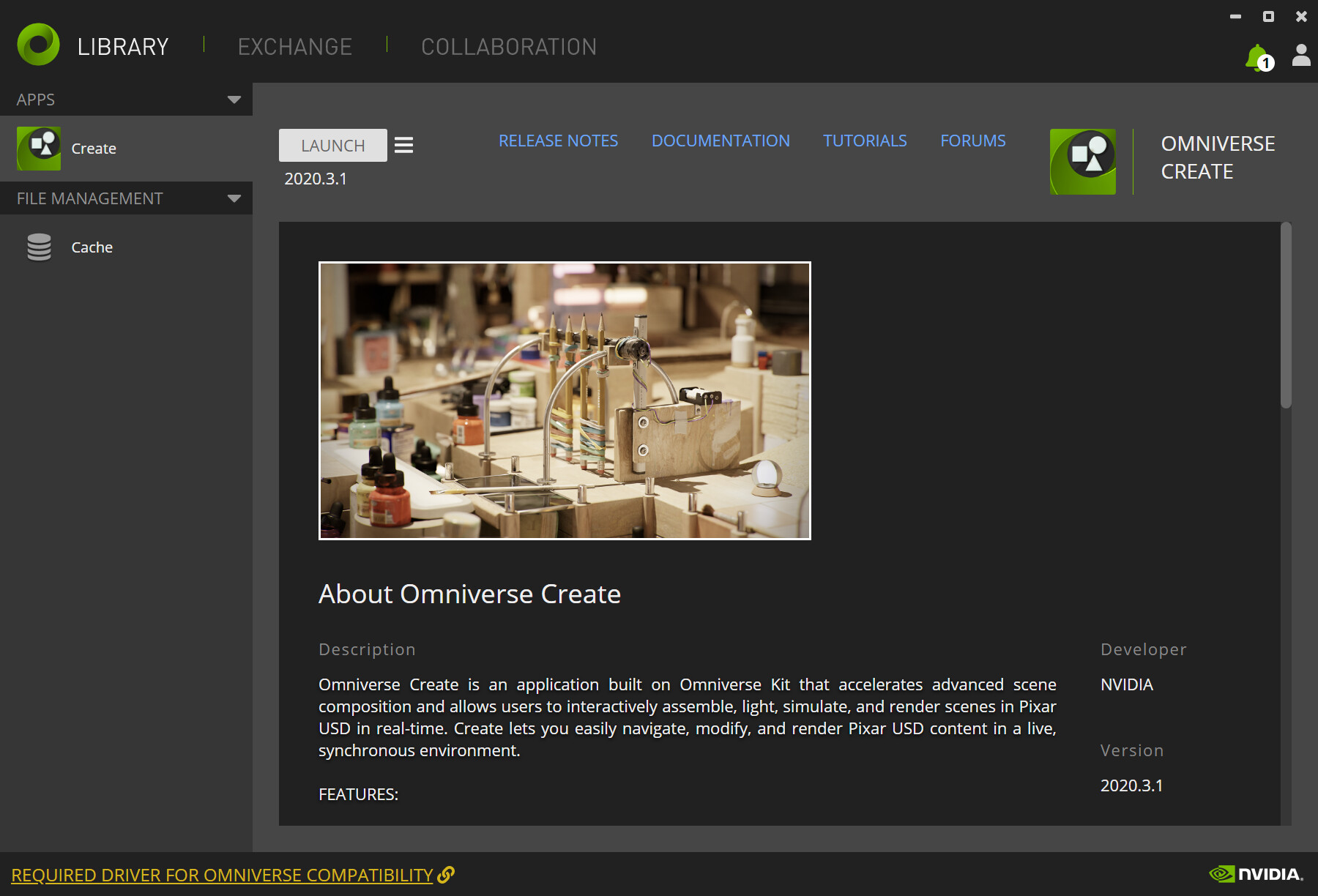

In order to get started with samples, you will need to enable collaboration by installing a local nucleus server.
Startup the Omniverse Launcher and go to the “Collaboration” tab then click the “+” to Add Local Collaboration Service.
Pick a location (with enough space to host projects)
Then create a local user (this is different from your NVIDIA login, it is only for this local Nucleus server admin).
Let the installation complete
You should now see a folder next to the “Local Nucleus Collaboration Service”. Click on that folder to explore your server content.
You should be able to see an “NVIDIA” folder as well as your local users and projects.
In the NVIDIA folder, you will find assets, samples, and materials
You can go ahead and launch an application like Create for instance
In the Content Browser, you should now see “localhost” with the structure we explored previously. You can load the Marbles scene by double-clicking on the .USD file in the sample folder.
