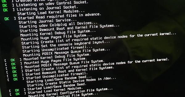

I have a PROBLEM about the install of GPU driver for both system of win10 and linux.
The notebook is Gigabyte aero 15 , i7-11800H with RTX3080.
The both system of win10 and ubuntu 18.04.5 LTS are workable.
Recently, I have a need for the development and running of GPU program under the linux.
I install the Nvidia linux (AMD64/EM64T) x64 display driver, version 460.91.03, etc.
The system shows this and STOP:
[[Album] Linux ![](https://global.discourse-cdn.com/nvidia/original/3X/9/8/98142114f1b8bbae4b1484538eadf7afb87d437c.jpeg "Linux") ](https://imgur.com/a/ZLypUYa)
 ![](https://global.discourse-cdn.com/nvidia/original/3X/4/7/47a2299ca41d299f3adce52d471e74ca7767725c.jpeg)
I try many times and different version of linux ubuntu 20.04and drivers 470.63.01.
Besides, I try to modify grub, adding “nomodeset”.
It’s all the same that I can not enter the system.
Did anyone encounter the similar problem and have the solution?[nvidia-bug-report.log.gz](https://forums.developer.nvidia.com/uploads/short-url/x3UFTnPLiaavxlr8Ko94oSdL8t6.gz) (6.2 KB)

I have the same problem, have you managed to solve it?
The only distro that works fine for me is **Pop! OS** version Nvidia.
Still, the second screen sometimes flickers, sometimes with design programs it gives problems.
I would love to be able to work with debian testing with non-free and contrib, but it doesn’t work, I have tested with some distros like linuxmint, ubuntu, debian among others and they don’t work well either.
Whenever I install the proprietary driver, at startup the screen stays black, in other tests it does not detect a second screen in xrandr, apparently, I do not know how to properly configure the xorg.conf for this.
Please, if someone has a correct solution to install Nvidia in **debian** let me know. Thanks.
Hardware: Laptop **i7-11800h + Nvidia 3050 ti**

It’s most likely a hybrid graphics system. For the i7-11800 you need a kernel 5.8 or higher and a recent mesa. Then configure prime. If that doesn’t help, please run nvidia-bug-report.sh as root and attach the resulting nvidia-bug-report.log.gz file to your post.

Hello, thank you for answering.
Correct, it is a hybrid.
**Tests with “unstable debian” and linuxmint:**
- I install the operating system.
- When rebooting it is necessary to put in the grub “splash nomodeset”.
- Free drivers work, but the performance is not good.
- I install the Nvidia 470.XX drivers, either from the repositories or manually by downloading the .sh
- On reboot the screen stays black with a small white line on the top left.
- I have tried adding a xorg.conf configuration, the system starts but only detects HDMI-0 (external display) and not eDP-1-1 (laptop display).
In time I will reinstall debian and generate the nvidia-bug-report.
