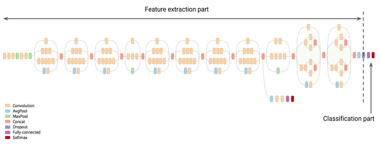

Will it be easier to incorporate into DeeppStream the following solution? Given the sources are provided as is in the documentation below? Would you be able to help with such implementation?
> **[Jump-Start AI Development](https://www.intel.com/content/www/us/en/developer/topic-technology/artificial-intelligence/overview.html)**
> A library of sample code and pretrained models provides a foundation for quickly and efficiently developing and optimizing robust AI applications.
