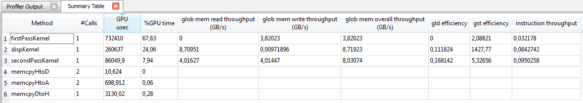

So for 1 request could be up to 16 transactions. Therefore efficiency should be from 1/16 to 1. But why I can see sometimes efficiency about 2000 ?
Where can you see global memory load or store efficiency values >1?
Here. Profiler screenshot is also attached.

Is that the version 3.0 profiler? It has some obvious bugs in the memory throughput and efficiency calculations - I get global memory throughputs of 500Gb/s from my GT200 with that version (see here).
I think you can discount them as wrong.
Thank you for answer. Profiler version is 2.3.10
