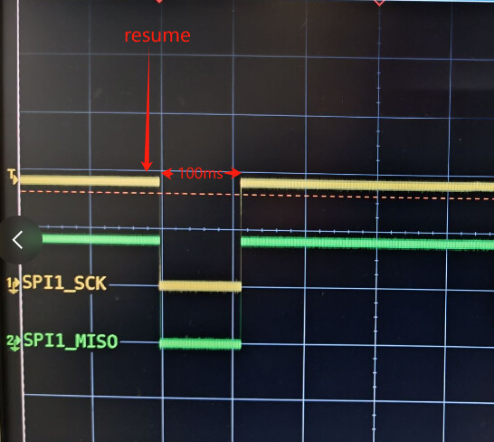

I set pins (SPI1_SCK,SPI1_MISO)on GPIO mode and high voltage, they can keep high during suspend, but when resuming , they have low pulse for 100ms like the following.
Could you help me to avoid this 100ms low pulse ?

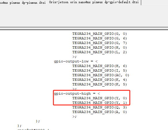

You should also update gpio dtsi to configure the default pin state.
Yes, I did update gpio dtsi as bellow:
gpio@2200000 {
gpio-init-names = “default”;
gpio-init-0 = <&gpio_main_default>;
gpio_main_default: default {
gpio-output-high = <
TEGRA234_MAIN_GPIO(Q, 3)
TEGRA234_MAIN_GPIO(Y, 0)
TEGRA234_MAIN_GPIO(Y, 1)
Could you configure them as above in pinmux spreadsheet and generate pinmux/gpio dtsi to check if the configurations are exact the same as yours?
I configure pinmux xls and generate pinmux/gpio dtsi again, the configurations are the same as mine.

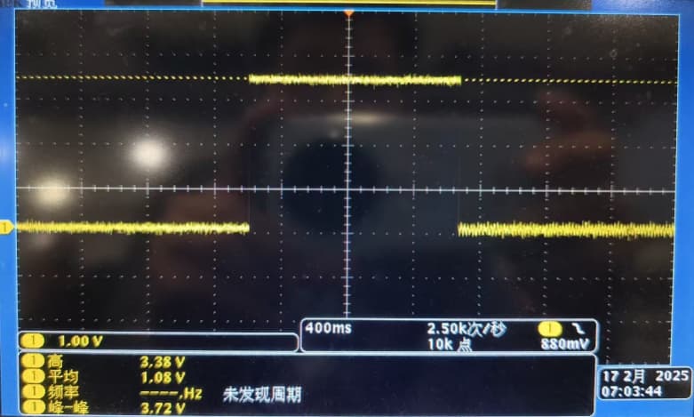

Have you also used a scope to check if the default state for these 2 pins is high after boot up?
Yes, these 2 pins is high after boot up.
I did the same test on dev kit
Pin 13 (SPI1_SCK) could keep high during resuming.

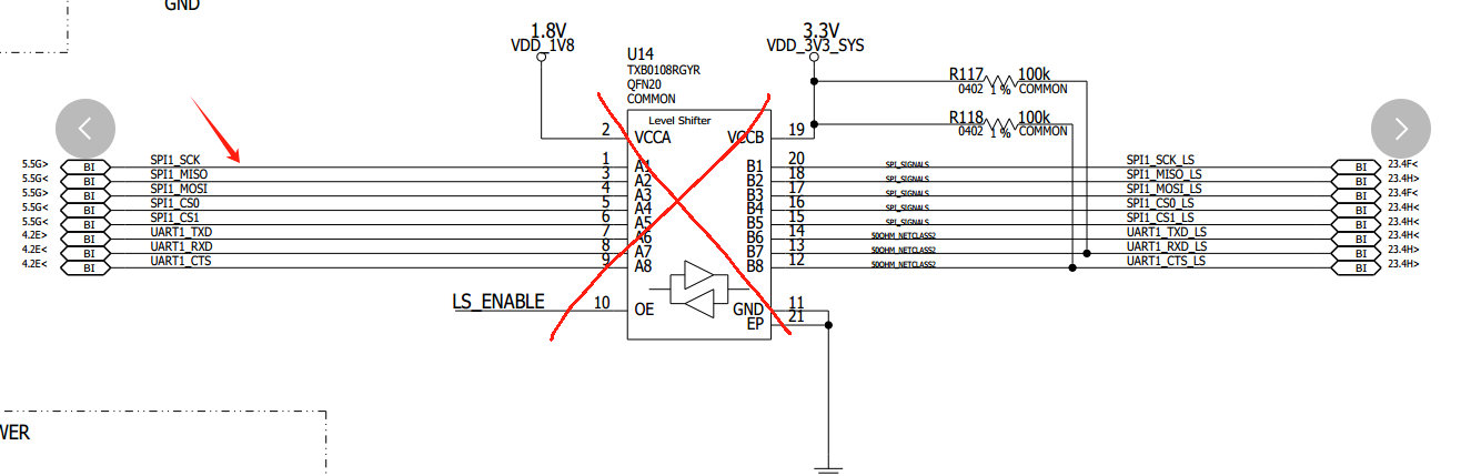

I removed “Level Shifter” and tested Pin SPI1_SCK on the CPU side , the Pin SPI1_SCK got 600ms low pulse
It seems these 2 pin would be in high impedance state during resuming. But the level shifter keep these 2 pin high.
Could Nvidia release a patch to fix this issue?
Isn’t it the expected result for your use case?
Why you need to remove the level shift?
The dev kit board with level shifter is OK, But the customer board does not have level shifter , It would cause low pulse.

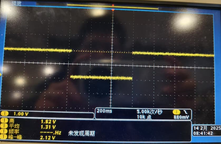

On dev kit board, These 2 PINs would not keep low voltage during resuming.
#gpioset --mode=signal gpiofind "PY.01"=0
sudo systemctl suspend
Short PWR BTN and ground PINs to resume
The below PIC shows the voltage of PIN22/40(SPI1_MISO) can not keep low voltage during resuming
How about if you’ve configured this pin as Input/PD in pinmux spreadsheet?
Do you suggest me to set this pin as input/PD ?
But what I need is setting this PIN as output. and expect ORIN NX keeps this PIN during suspend & resume .
I set this pin correctly
It would be high voltage by " gpioset --mode=signal gpiofind "PY.01" =1" command
and be low voltage by " gpioset --mode=signal gpiofind "PY.01" =0" command
